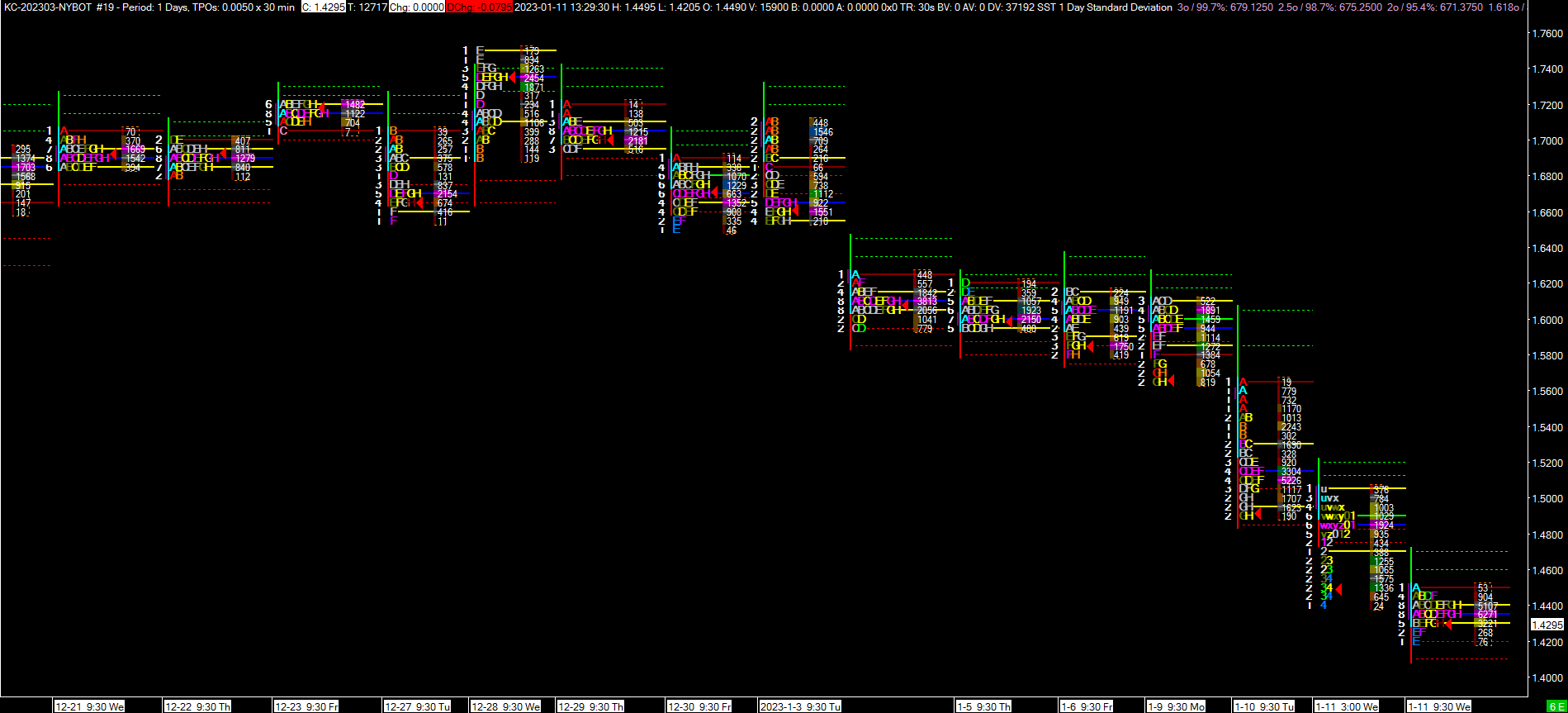

User584084 - Posts: 348
Attached is a screenshot of a TPO chart for ICE March 2023 Coffee KC-202303-NYBOT with IB intraday data (15 min delayed). I am running IB TWS offline Version 10.20.1f and SC Version 2457. I downloaded 30 days of IB intraday data without issue. Make sure you have the latest version of both SC and IB TWS.
If you are still having issues downloading IB intraday data for Coffee, post your message log file.
Date Time Of Last Edit: 2023-01-11 23:30:43

[2023-01-12 18:24:53]
AcquaLife - Posts: 33
I did not have the updated SC. Once i updated it it works perfectly. I can download as much data as I want. Not sure why above poster can only get 30 days...
Thank you for the help!
