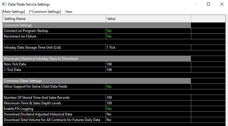

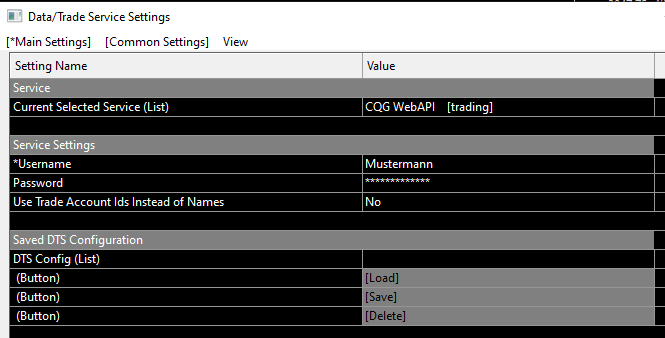

my settings are attached
imageScreenshot_1.png / V - Attached On 2023-01-10 07:48:01 UTC - Size: 12.94 KB - 267 views
imageScreenshot_2.png / V - Attached On 2023-01-10 07:48:08 UTC - Size: 18.83 KB - 290 views

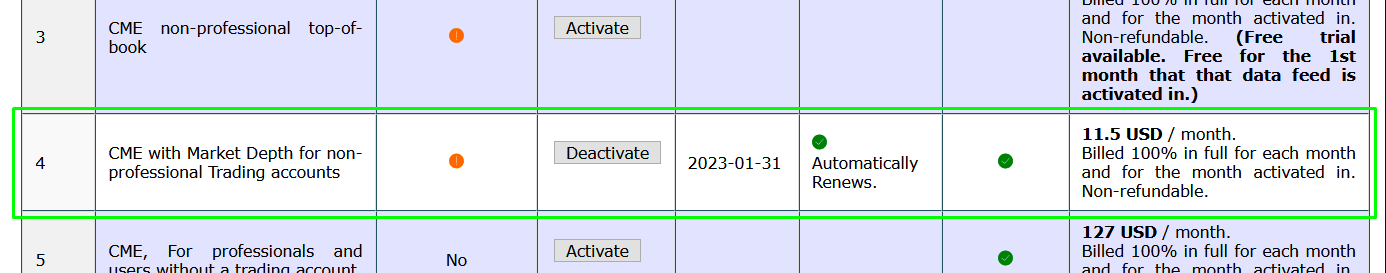

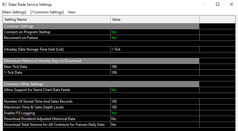

imageScreenshot_3.png / V - Attached On 2023-01-10 16:33:56 UTC - Size: 68.75 KB - 246 views
imageScreenshot_4.png / V - Attached On 2023-01-10 16:34:02 UTC - Size: 31.6 KB - 242 views
imageScreenshot_5.png / V - Attached On 2023-01-10 16:34:58 UTC - Size: 16.45 KB - 272 views
[2023-01-10 17:30:36]
You are already setup for the Denali Exchange Data Feed. But you need to connect your Sierra Chart to your CQG account in order to make the verification for the CME Group non-professional requirement. Once you complete the setup to CQG you will be able to get the real-time data from our Denali Exchange Data Feed.
As noted above, you will just need to determine how you want to move forward with the connection to ensure you have the correct symbols based on your Current Selected Service.

"Current Selected Service (List)"
must switch from "SC Data - All Services"
to "CQG WebAPI"
The login data are not those of AMP Futures, as I needed them for Rithmic, but others that I got from AMP Futures.
It finally worked and SierraChart showed me the data in real time!

3.1. Current Selected Service (List)
switch from SC Data - All Services [data]
on
CQG WebAPI [trading]
3.2 Service Settings
Username >> "for CQG account" (you got it from your broker)
Password >> "for CQG account" (you got it from your broker)
4. OK

imageScreenshot_3.png / V - Attached On 2023-01-11 09:10:32 UTC - Size: 12.61 KB - 274 views
imageScreenshot_1.png / V - Attached On 2023-01-11 09:10:39 UTC - Size: 12.94 KB - 328 views
imageScreenshot_2.png / V - Attached On 2023-01-11 09:10:45 UTC - Size: 18.83 KB - 238 views
