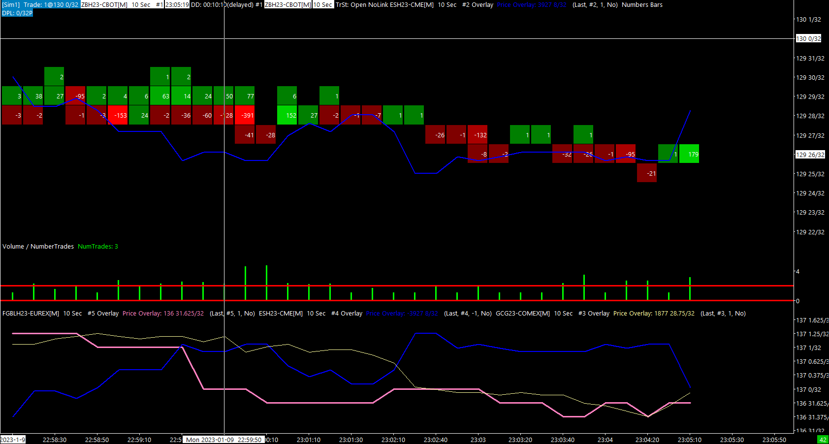

Here is the screeshot
https://www.sierrachart.com/image.php?Image=1673287128987.png
i marked some of the missing candles but not all and the problem is not missing ones, if it was live i wouldnt see that 10 or 20 seconds.
I wish its just Trial data complications

https://www.sierrachart.com/image.php?Image=1673295333651.png
ı took this screenshot now,
-95 red cadle = 23:04:10
-21 red candle = 23:04:20
1 green candle = 23:04:40
[2023-01-09 22:35:31]
You are not missing anything. As you can see from your data, this is not a highly traded instrument. There are many bars where you are showing a quantity of 1 within the 10 second period. Therefore, the fact that you are missing some time periods is only because there was no trading during that 10 second period. If you increase your bar period to 1 minute, then it will not be so glaring. Or, you can turn on the option for Chart >> Chart Settings >> Bar Period >> Include Columns with No Data in order to make each 10 second period show up. Refer to the following:

[2023-01-09 23:40:28]
User797751 - Posts: 5
Thanks,
"Include columns with no data" solved my problem.
In that case if there are no trades at that moment , the chart header delayed data wont refresh itself.
It would refresh simultaneously in live data i guess.
I was afraid of bigger technical problems, but i missed that box in chart settings.
I am going to check it again but that seems ok now .
