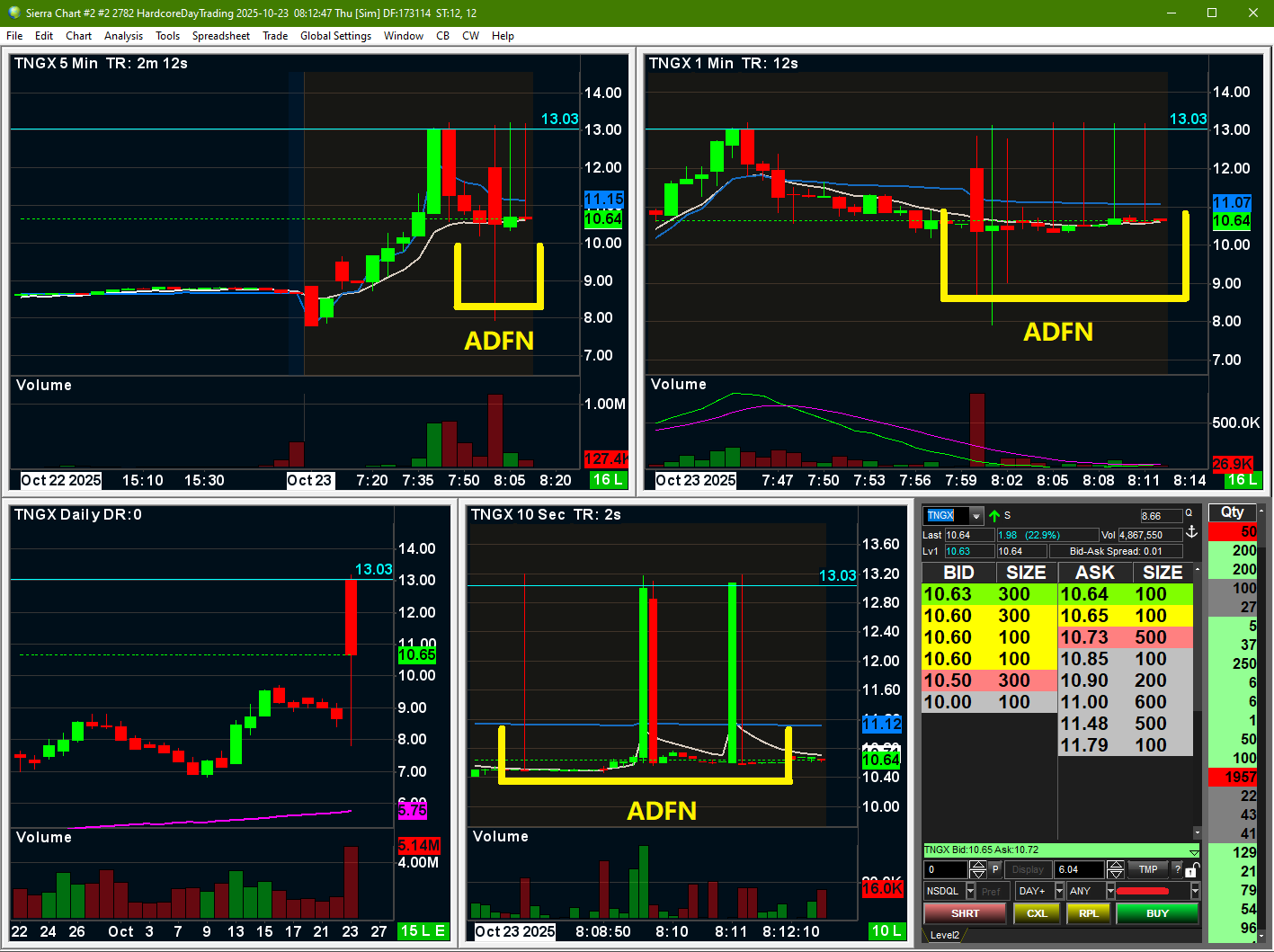

At 8:00 AM pre-market there's ADFN orders that go through the tape which also show on the chart and clutter it quite much.
Is there a way to prevent them from showing, or alternatively, edit the candles on the chart itself to remove the erroneous data?

[2024-01-18 13:33:31]
BenjFlame - Posts: 353
My broker feed, and various other app I use, removed ADFN orders which are delayed and erroneous prints.
Thus the chart is not polluted by ridiculously tall prints that distort the chart and make it unreadable, in particular with the garbage of 8:00 AM.
I also suggest you remove ADFN orders from your consolidated feed.
Here is comparison from unedited broker feed chart and SierraChart. Those trades distorting the chart never occurred at that time.
SierreChart on the bottom, both 1 mn charts.
Date Time Of Last Edit: 2024-01-18 13:34:50
imageScreenshot 2024-01-18 083212.png / V - Attached On 2024-01-18 13:33:25 UTC - Size: 39.33 KB - 450 views
[2025-04-01 12:48:03]
Hello SierraChart, so, can you please find a way to remove those trades ?
Lots of feeds providing the consolidated feed do it.... It would be great if sierrachart can do it also. Too many times, SC charts for stocks are destroyed by these trades that don't appear elswhere.
[2025-10-23 23:17:36]
AlexH4 - Posts: 28
I completely agree that would be really cool because every time at 8am all my chart is screw up buy those big candle ADFN Order... i just stop trading a this point....
imageadfn.png / V - Attached On 2025-10-23 23:17:15 UTC - Size: 124.26 KB - 256 views

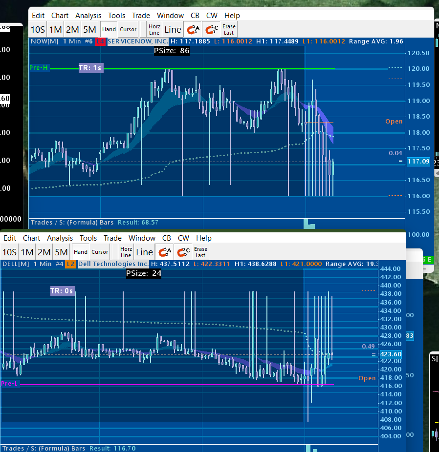

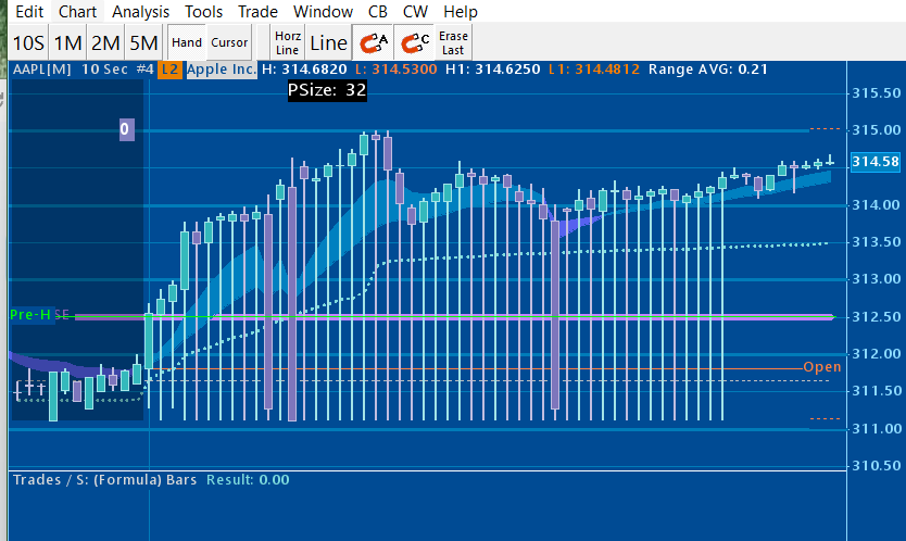

[2026-05-29 15:11:01]
This is not tolerable, look at those charts, how are we supposed to trade this !!
Why am i even paying for this?!
No other plateform is affected by this crap. And it's not just 8AM. It's all day long.
Date Time Of Last Edit: 2026-06-01 11:21:01
imageScreenshot 2026-05-29 093902.png / V - Attached On 2026-05-29 15:09:40 UTC - Size: 145.58 KB - 168 views
imageScreenshot 2026-05-29 112414.png / V - Attached On 2026-05-29 15:25:03 UTC - Size: 40.12 KB - 152 views
[2026-08-17 05:37:37]
Sierra_Chart Engineering - Posts: 25249
It is definitely not fair at all to be calling this "crap". This is not the case at all. Sierra Chart provides the actual industry data feed. If we remove alternative display facility trades, we would be taking out about 70% or so of the volume. We did analyze this previously. The thread is here:
Notice: Regarding Premarket Off Price Trades in US Equities
And it is not all day long. That is completely and totally false. This has never been the case. If you include Odd Lot trades, sometimes you will see trades that are outside of the normal price range. But you can remove those:
Chart Settings: Include Odd Lot Equity Trades (Chart >> Chart Settings >> Chart Data >> Chart Data menu)
So you must be including Odd Lot trades. The option to remove those, has been in place for many years now.
Out of range trades, that are not Odd Lots are only during the pre-and post-market. Not during regular trading hours.
Anyway, the reason we are posting here, in about 30 days or so maybe sooner, Alternative Display Facility trades from FINRA will be identified in the data stream. And we will add the capability to filter them out. So you will be able to filter those out through a Chart Setting.
But we suspect when you actually see what that option is going to do, you are not going to be happy with it since you will lose a lot of volume. Unless we limit it to the pre-or post-market.
Date Time Of Last Edit: 2026-08-17 05:40:40
