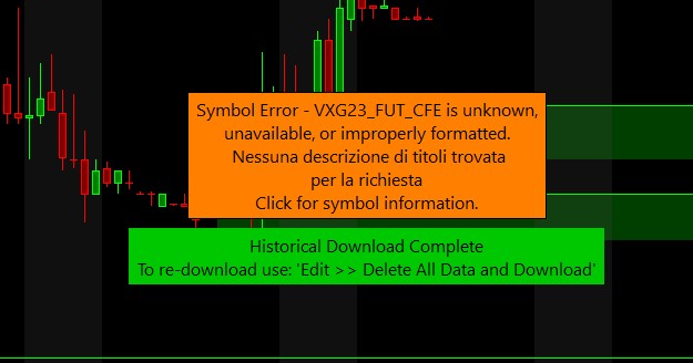

I keep getting a message saying "Symbol Error - VXG23_FUT_CFE is unknown, unavailable, or improperly formatted..."
How can I fix it?
Thank you
imageImmagine 2022-12-15 152630.jpg / V - Attached On 2022-12-15 15:24:31 UTC - Size: 43.47 KB - 210 views

I've tried all of that and the problem is still present

The chart is on a Sub-Instance, but even updating the symbol settings from the main instance the problem is still there. The symbol is VXF23_FUT_CFE.
This is the Message Log:

[2022-12-16 15:50:44]
We need to work with your main instance first and make sure you are able to get the data into the main instance.
Please go through the following process to get us your Message Log from the Main Instance for the symbol VXF23_FUT_CFE:
Open a chart for the symbol you have an issue with. Tell us that symbol of the chart.
[2022-12-16 16:28:31]
User447301 - Posts: 10
The problem is with the symbol VXF23_FUT_CFE.
Here's the Message Log:

IB Account information received. | 2022-12-16 11:25:23.485
Interactive Brokers | Received 1 Trade Accounts from TWS. | 2022-12-16 11:25:23.485
Interactive Brokers | Connected to Live account. | 2022-12-16 11:25:23.485
Updated verified funded futures trading account ending date to: 2023-01-15 16:25:23 | 2022-12-16 11:25:23.485
Interactive Brokers | Connected to server complete. | 2022-12-16 11:25:23.485
Triggering next historical data download in queue. | 2022-12-16 11:25:23.485
Message from IB: Connessione con il Server dei dati di mercato � OK:usfarm.nj. IB Error Code: 2104. Request ID: -1. | 2022-12-16 11:25:23.486
Message from IB: Connessione con il Server dei dati di mercato � OK:eufarm. IB Error Code: 2104. Request ID: -1. | 2022-12-16 11:25:23.486
Message from IB: Connessione con il Server dei dati di mercato � OK:usfarm. IB Error Code: 2104. Request ID: -1. | 2022-12-16 11:25:23.486
Message from IB: Connessione con il HMDS data farm � OK:ushmds. IB Error Code: 2106. Request ID: -1. | 2022-12-16 11:25:23.486
Message from IB: Connessione alla raccolta dati Sec-def stabilita:secdefnj. IB Error Code: 2158. Request ID: -1. | 2022-12-16 11:25:23.486
No download requests in the queue to start downloads for. | 2022-12-16 11:25:23.486
Next valid order ID: 605 | 2022-12-16 11:25:23.486
Mapping VXF23_FUT_CFE to VXF23_FUT_CFE. Service code: cfe_exchange.data | 2022-12-16 11:25:23.555
Using symbol data fast lookup vector | 2022-12-16 11:25:23.555
SC Data - All Services | Starting real-time market data updates for: VXF23_FUT_CFE (VXF23_FUT_CFE). ID: 1 Service code: cfe_exchange.data | 2022-12-16 11:25:23.556
SC Data - All Services | Connecting to the server ds25.sierracharts.com. Port 443 | 2022-12-16 11:25:23.556
SC Data - All Services | Requesting security definition data for: VXF23_FUT_CFE (VXF23_FUT_CFE). ID: 1 | 2022-12-16 11:25:23.556
Added historical Intraday data request for VXF23_FUT_CFE to the queue. | 2022-12-16 11:25:23.556
Intraday data recording state for symbol VXF23_FUT_CFE is set to download 'Pending'. | 2022-12-16 11:25:23.556
Triggering next historical data download in queue. | 2022-12-16 11:25:23.556
DTC Client socket (2) | Creating socket. | 2022-12-16 11:25:23.556
DTC Client socket (2) | New receive buffer size: 5242880 | 2022-12-16 11:25:23.556
DTC Client socket (2) | Connecting to IP: 38.65.8.115. | 2022-12-16 11:25:23.556
Delaying start of download for VXF23_FUT_CFE. | 2022-12-16 11:25:23.565
Next valid order ID: 605 | 2022-12-16 11:25:23.585
SC Data - All Services | Network connection to server complete. | 2022-12-16 11:25:23.667
SC Data - All Services | Starting socket receive thread. | 2022-12-16 11:25:23.667
SC Data - All Services | Sending encoding request to server: Binary VLS. Compression: high | 2022-12-16 11:25:23.667
Interactive Brokers | Requesting Trade Positions snapshot and updates (IB account data updates (6)) for account: U787* | 2022-12-16 11:25:23.747
Interactive Brokers | Begin Trade Positions processing. | 2022-12-16 11:25:23.749
Interactive Brokers | Sending request for contract details for contract ID 128884495 | 2022-12-16 11:25:23.749
Interactive Brokers | Received Trade Positions download end message for account U787* | 2022-12-16 11:25:23.750
Interactive Brokers | Received Trade Positions for all accounts. Performing final processing. | 2022-12-16 11:25:23.750
SC Data - All Services | Setting DTC encoding to Binary VLS | 2022-12-16 11:25:23.801
SC Data - All Services | Sending logon request message. | 2022-12-16 11:25:23.801
Symbol Error - VXF23_FUT_CFE is unknown, unavailable, or improperly formatted. Nessuna descrizione di titoli trovata per la richiesta | 2022-12-16 11:25:23.813
Interactive Brokers | Received contract details for symbol VUSA-STK-SMART-EUR | 2022-12-16 11:25:23.948
Interactive Brokers | All contract details received for symbols used for trading. Starting timer to request trading data. | 2022-12-16 11:25:23.948
HD Request # 29 | Downloading Intraday chart data for VXF23_FUT_CFE to the file VXF23_FUT_CFE.scid. Service: cfe_exchange.data | 2022-12-16 11:25:24.016
HD Request # 29 | Download start date-time: 2022-12-16 11:25:04.000000. File last date-time: 2022-12-16 11:25:04.084001 | 2022-12-16 11:25:24.017
HD Request # 29 | Using server: ds25.sierracharts.com port 10149 | 2022-12-16 11:25:24.017
Socket (4) | Creating socket. | 2022-12-16 11:25:24.017
Socket (4) | New receive buffer size: 5242880 | 2022-12-16 11:25:24.017
Socket (4) | Connecting to IP: 38.65.8.115. | 2022-12-16 11:25:24.017
HD Request # 29 | Setting DTC encoding to Binary VLS | 2022-12-16 11:25:24.480
HD Request # 29 | Sending historical data logon request message. | 2022-12-16 11:25:24.480
SC Data - All Services | Received logon response. | 2022-12-16 11:25:24.553
SC Data - All Services | Server Name: SC Realtime Server. | 2022-12-16 11:25:24.553
SC Data - All Services | Server protocol version: 8. Client protocol version: 8 | 2022-12-16 11:25:24.553
SC Data - All Services | Successfully connected. | 2022-12-16 11:25:24.553
SC Data - All Services | Trading is not supported. | 2022-12-16 11:25:24.553
SC Data - All Services | Restarting real-time data updates for symbol: VXF23_FUT_CFE -> VXF23_FUT_CFE | 2022-12-16 11:25:24.553
SC Data - All Services | Received security definition for symbol VXF23_FUT_CFE | 2022-12-16 11:25:24.741
HD Request # 29 | Requesting Intraday data. Start date-time: 2022-12-16 11:25:04. Record interval: 0. Symbol: VXF23_FUT_CFE | 2022-12-16 11:25:25.173
HD Request # 29 | Decompressing data. | 2022-12-16 11:25:25.436
HD Request # 29 | Receiving Intraday data for VXF23_FUT_CFE starting at 2022-12-16 11:25:04.083000 | 2022-12-16 11:25:25.436
Socket (4) | CloseSocket call. | 2022-12-16 11:25:25.436
Socket (4) | Shutdown started. Waiting for graceful close. | 2022-12-16 11:25:25.437
Historical data download thread signaled to stop. | 2022-12-16 11:25:25.437
HD Request # 29 | Timestamp of first Intraday data file record written: 2022-12-16 11:25:07.862000. | 2022-12-16 11:25:25.437
HD Request # 29 | Received 26 Intraday data records from 2022-12-16 11:25:04.083000 to 2022-12-16 11:25:21.447000 (17.4 seconds) and wrote 11 records for VXF23_FUT_CFE | 2022-12-16 11:25:25.437
HD Request # 29 | Completion time: 1s. | 2022-12-16 11:25:25.437
HD Request # 29 | Intraday data download complete for VXF23_FUT_CFE. Unique request ID: 29 | 2022-12-16 11:25:25.437
Removing historical data download ID 29. | 2022-12-16 11:25:25.437
Real-time Intraday chart data file updates started for VXF23_FUT_CFE | 2022-12-16 11:25:25.437
Intraday chart data file opened for VXF23_FUT_CFE | 2022-12-16 11:25:25.437
HD Request # 29 | Enabling Intraday chart updating for symbol. | 2022-12-16 11:25:25.437
Triggering next historical data download in queue. | 2022-12-16 11:25:25.437
No download requests in the queue to start downloads for. | 2022-12-16 11:25:25.437
Socket (4) | Socket gracefully closed by remote side. | 2022-12-16 11:25:25.697
Socket (4) | Closed. | 2022-12-16 11:25:25.697
Opened cached Intraday file: D:\SierraChart\Data\VXF23_FUT_CFE.scid. Thread ID: 67168 | 2022-12-16 11:25:28.012
Interactive Brokers | Stopping automatic Trade Position updates for account: U787* | 2022-12-16 11:25:33.950
Interactive Brokers | Requesting Trade Positions snapshot and updates (IB account data updates (6)) for account: U787* | 2022-12-16 11:25:33.950
Message from IB: Sottoscrizione del client API interrotta dai dati del conto. IB Error Code: 2100. Request ID: -1. | 2022-12-16 11:25:33.952
Interactive Brokers | Begin Trade Positions processing. | 2022-12-16 11:25:34.051
Interactive Brokers | Received Trade Positions download end message for account U787* | 2022-12-16 11:25:34.051
Interactive Brokers | Received Trade Positions for all accounts. Performing final processing. | 2022-12-16 11:25:34.051
DTC Client socket (3) | Timed out waiting for shutdown. Performing an immediate socket close. | 2022-12-16 11:27:20.906
DTC Client socket (3) | Closed. | 2022-12-16 11:27:20.906
DTC Client socket (7) | Timed out waiting for shutdown. Performing an immediate socket close. | 2022-12-16 11:27:20.906
DTC Client socket (7) | Closed. | 2022-12-16 11:27:20.906
[2022-12-16 17:29:26]
Based upon what we see you are getting data for this symbol:
Provide an image of the chart for that symbol, by following these instructions:
Date Time Of Last Edit: 2022-12-16 17:29:40

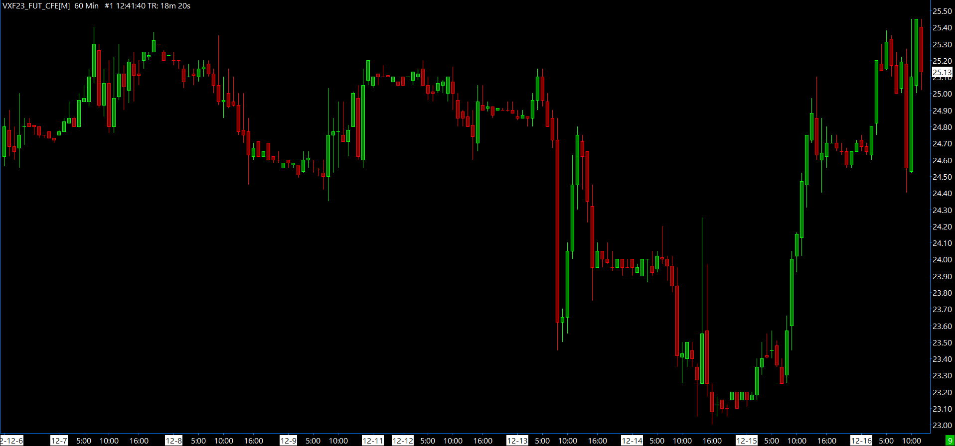

[2022-12-16 17:42:28]
https://www.sierrachart.com/image.php?Image=1671212506828.png
[2022-12-16 17:51:39]
So this chart is then not updating in real time?
[2022-12-16 18:02:25]
I'm not sure about that. I only watch it through Sierra Chart, so I can't compare
Date Time Of Last Edit: 2022-12-16 18:03:10
