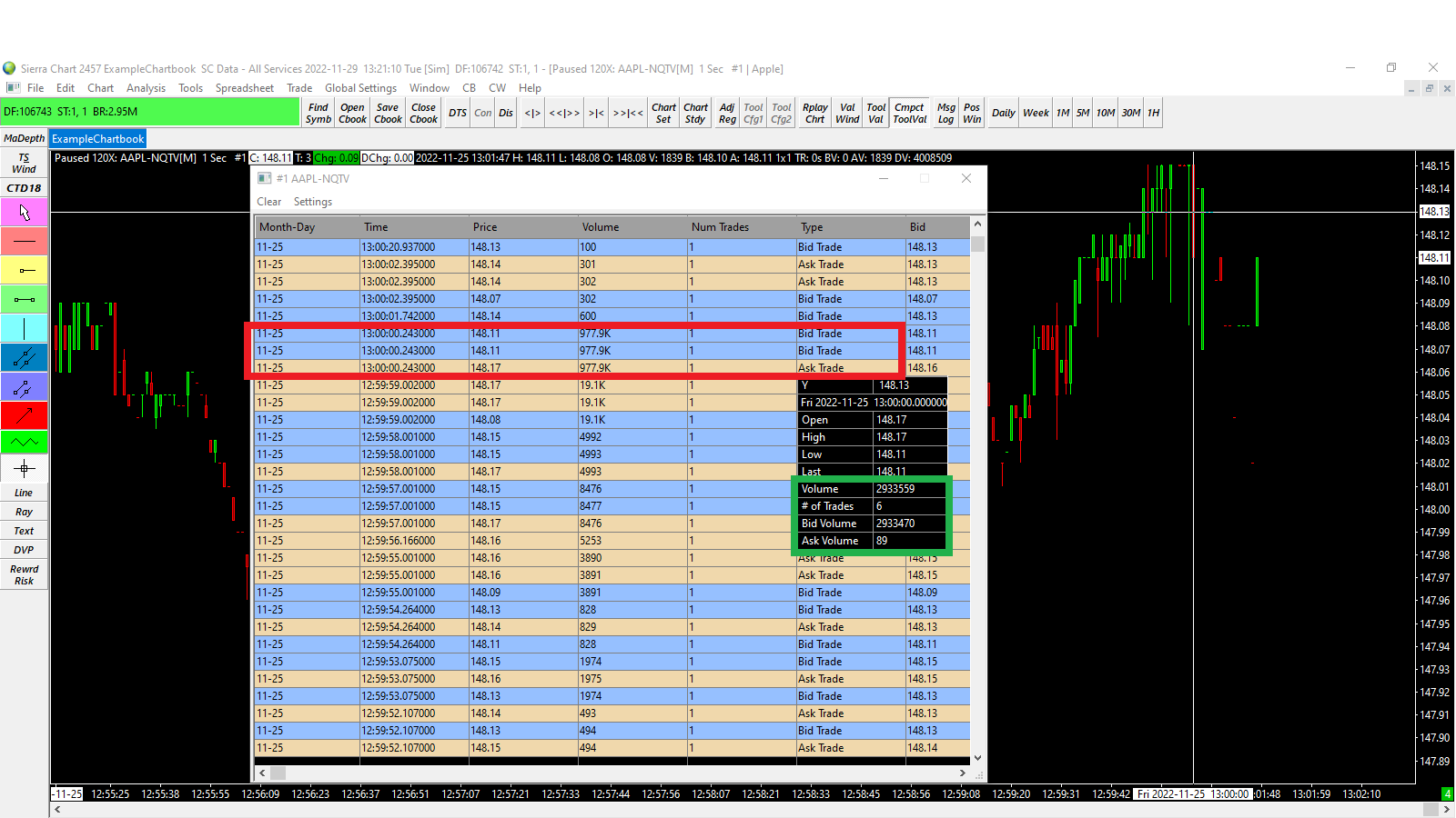

During the real time data there is no difference between the information of Compact Tool Value Windows per candle stick (1 Sec) in the chart and the information of Time and Sales Window, but when I want to view the historical data using Reply Chart I see that these information differ from each other. even Interaday Data Storage Time Unit in Data/Trade Service settings is set to 1 tick. See the picture
imageTime and sales.png / V - Attached On 2022-11-29 18:24:24 UTC - Size: 107.05 KB - 240 views

Maybe you are using Combining options in the Time and Sales window?
This is what we see at 13:00 US Eastern time on 11-25:
https://www.sierrachart.com/image.php?Image=1669759220544.png
The data in the Time and Sales window does represent the actual tick by tick data at that time.
Set Sierra Chart to a Tick by Tick Data Configuration. Follow the instructions here to do this:
Date Time Of Last Edit: 2022-11-29 22:03:07
