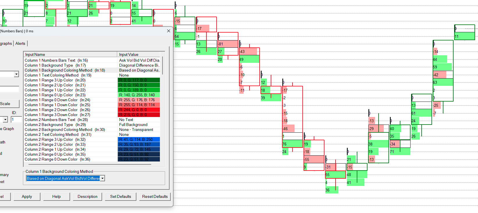

PhilipJamesB - Posts: 22
This looks amazing, already finding it helpful. In case anyone is wondering about the settings, I've attached a screenshot of mine.
Thanks so much Sierra Team!
imageVolume Delta Profile settings.png / V - Attached On 2025-10-13 09:06:06 UTC - Size: 141.08 KB - 363 views
