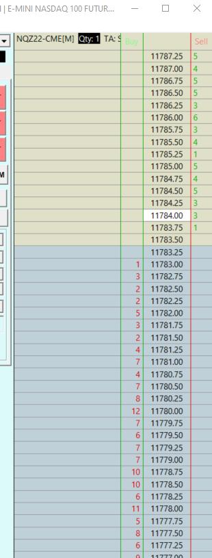

I want to start using the DOM for my trading and I pulled it up. When I used Replay to practice watching it, it only showed 1 - 1. How do i get it to work properly? Thanks
imageCapture.PNG / V - Attached On 2022-11-13 20:35:37 UTC - Size: 18.13 KB - 238 views

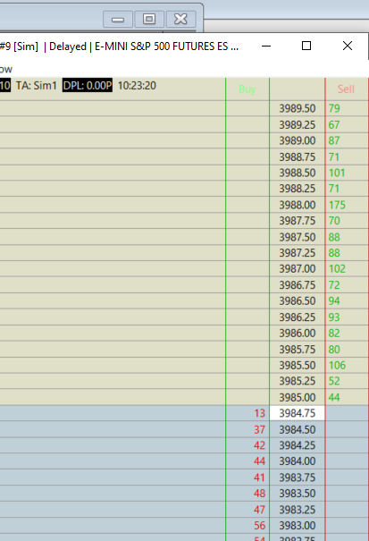

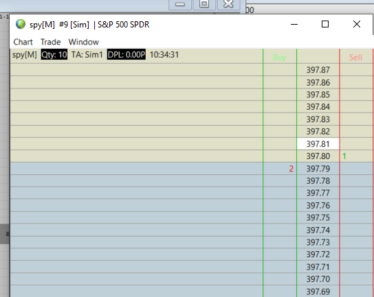

Thank you it fixed the problem. But now i am not seeing data for spy and qqq, what should i do to get them to work properly. It also says that my ES mini futures have delayed data how do i make them real-time?
imagespy.PNG / V - Attached On 2022-11-14 16:38:41 UTC - Size: 42.81 KB - 273 views
imagedelayed.PNG / V - Attached On 2022-11-14 16:38:56 UTC - Size: 62.11 KB - 291 views

To specify that you are wanting the data from the NASDAQ TotalView instead of our U.S. Equites, you need to add a '-NQTV' to the symbol name. So for SPY, you would need to enter the symbol SPY-NQTV.
Your ES is delayed because you are not setup to get any real-time data for the CME Group from us. Refer to the information at the following link for setting up the Denali Exchange Data Feed for the CME Group (be sure you understand the requirements for a non-professional account):

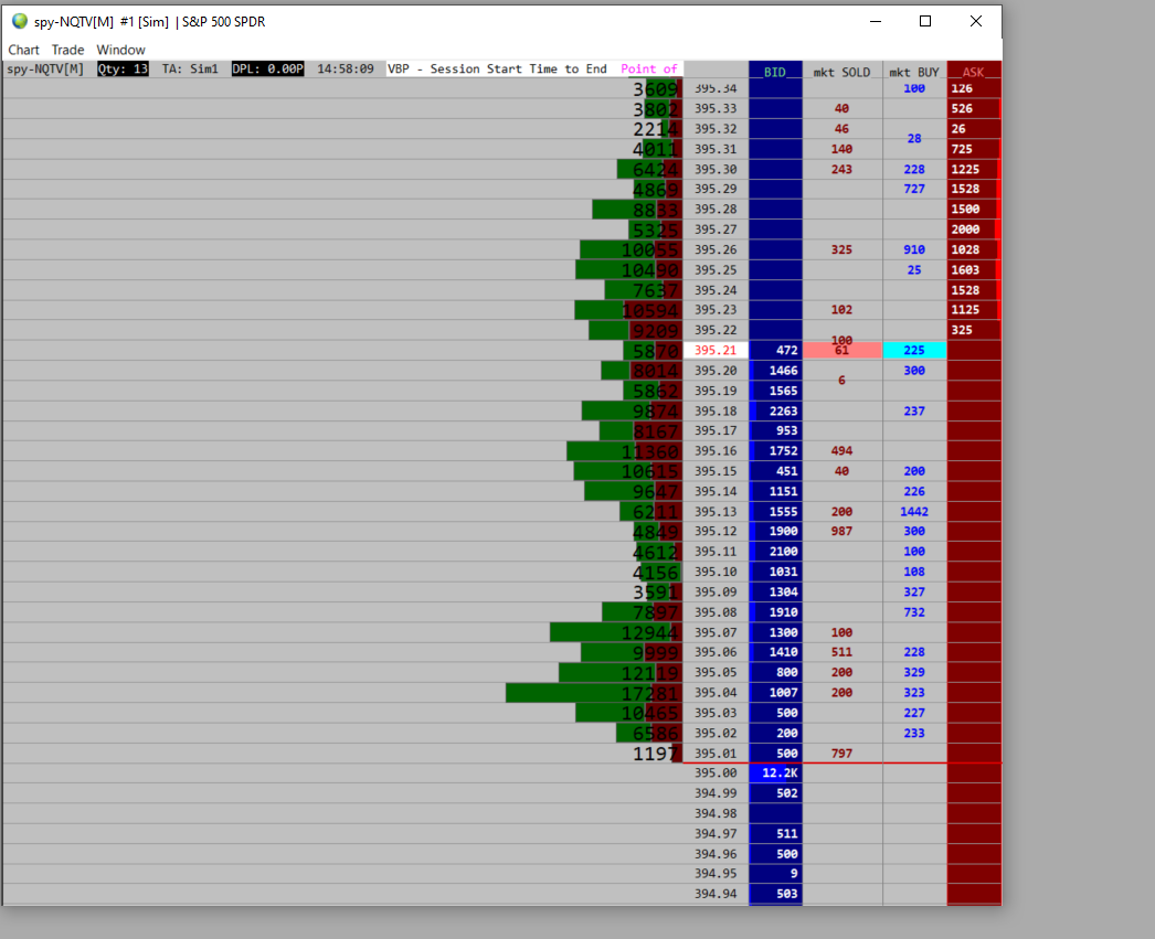

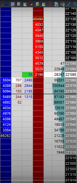

I am trying to get my DOM to resemble the one that Jigsaw trading uses. I provided a picture below of what jigsaw DOM looks like
imageJigsaw.PNG / V - Attached On 2022-11-14 21:15:54 UTC - Size: 232.1 KB - 319 views
[2022-11-15 15:49:41]
John - SC Support - Posts: 47939
You can definitely get it to look like that, apart from the Volume Profile on the right (we do not have a way to put a volume profile within the DOM columns).
You have to adjust the column positions as you want them and all the colors can be adjusted. Refer to the following:
Chart Trading and the Chart DOM: Customizing Trade DOM and Chart DOM Columns

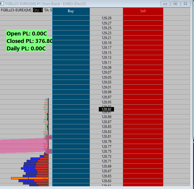

User569276 - Posts: 1
hello, I contact you because i need assistant with my DOM : my DOM look like weird and i woold like to try to kix it. i already pay the 25 dollars to have the flux and it's the good one but it's look like this (in the attached picture) and i don't undertand
thank you
imageCapture.PNG / V - Attached On 2023-10-29 20:14:26 UTC - Size: 31.09 KB - 212 views
[2023-10-29 20:28:14]
Sierra_Chart Engineering - Posts: 24910
First of all, the market is closed at this time. Let us wait until the market opens and there is market depth data, and then tell us specifically what you need help with regarding the Trading DOM.
