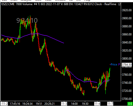

I have denali + Rithmic but it loads holes. How to fix?
View Count: 789
[2022-11-07 08:38:52]
Jia T P R - Posts: 26
See attachment:
I read the threat about rithmic and i would like that it works again pls. Using this Feed since 2018. Last year with Denali and it worked fine
imageSC issue.png / V - Attached On 2022-11-07 08:38:13 UTC - Size: 20.54 KB - 220 views
[2022-11-07 13:17:48]
You are not actually using the Denali data feed with Rithmic for the reason given below.
This applies both to historical and real-time data.
The reason you are not getting real-time data from the CME Group of exchanges is that you activated the Non-Professional exchange fees, but you have not verified in the last month that you have a live, funded, futures trading account, which the CME needs in order to allow you data at the lower priced fees.
Refer to the following for instructions on how to connect once a month to your *live funded* trading account to qualify for the lower-priced exchange fees:
If you do not have a funded trading account or one with a supported trading service, then refer to this solution:
Easy Solution to CME Funded Trading Account Requirement
Consider the above solution to avoid this problem in the future.
[2022-11-08 07:49:59]
When i want to use a Rithmic Paper account i would also need to make an account with Stage 5 or Edge clear, make a balance of 200$ with teton routing and connect that once a month right?
[2022-11-08 13:43:28]
Yes this is true if you have no other real trading account? 100 USD is enough.
