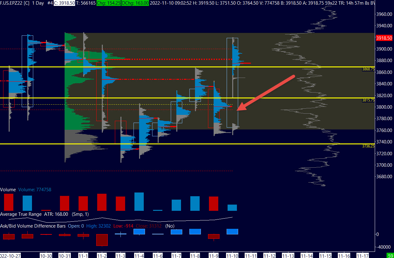

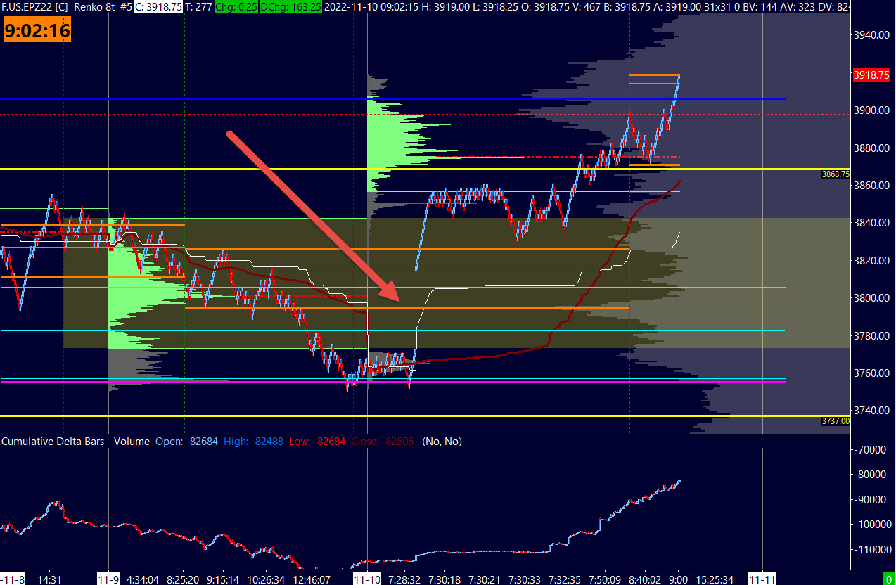

[2022-11-10 15:11:34]
User75949 - Posts: 142
I'm still experiencing problems on data, I made "Delete and download Data" but nothing changes,
I'm on the lates SC version, never happened to me with Sierra in the past (over 10 years)
please let me know
(you can see from the pictures attached)
regards
imagedaily profiles.jpg / V - Attached On 2022-11-10 15:10:54 UTC - Size: 273.94 KB - 176 views
image8tick renko.jpg / V - Attached On 2022-11-10 15:11:02 UTC - Size: 330.07 KB - 185 views
[2022-11-10 16:11:48]
It looks like you are showing issues from a Sub-Instance. If this is the case, then you would need to open a chart for the same symbol in your Main Instance (if you do not already have a chart open) and then go through the process as outlined at the following link to redownload missing data:
Data Errors or Spikes in Charts, Flat or Flat Line Graph, Compressed Graph, Errors with Date/Time Values: 2.1.2 Deleting and Re-downloading Data. (Easier and Recommended Method)
Once you have the main instance showing the correct data, then you can repeat the process to delete and redownload the data in the sub-instance and that should take care of it.

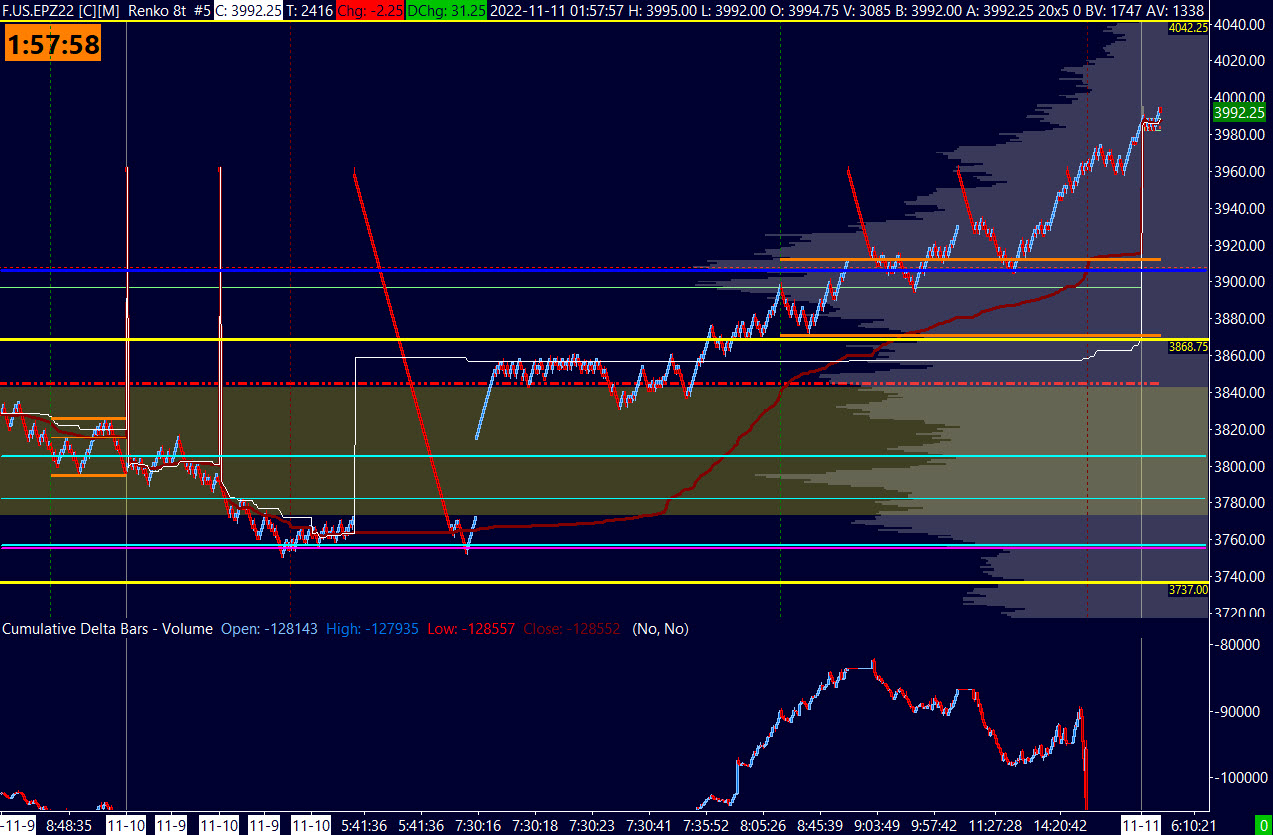

[2022-11-11 08:17:21]
Unfortunately didn't work, even on the main instance.
Done the "Delete and download data" but nothing changes... some other fellow traders have had lately similar issues
I've sent for analysis the Message Log few minutes ago
Now I will delete and re download the scid file of ES and NQ
attached a file of a chart..
please let me know
regards
image8tick renko.jpg even worse now.jpg / V - Attached On 2022-11-11 08:16:45 UTC - Size: 318.88 KB - 206 views
[2022-11-11 10:45:09]
First use a 1 Minute, not Renko, chart and check for missing data that way. And then re-download the data with this command:
Re-download all the data in the chart by going to the chart and selecting "Edit >> Delete All Data and Download". You just need to do this once per symbol and not for each chart.
Part of the problem could be something related to a Renko chart making it look like there is missing data when there is not.
