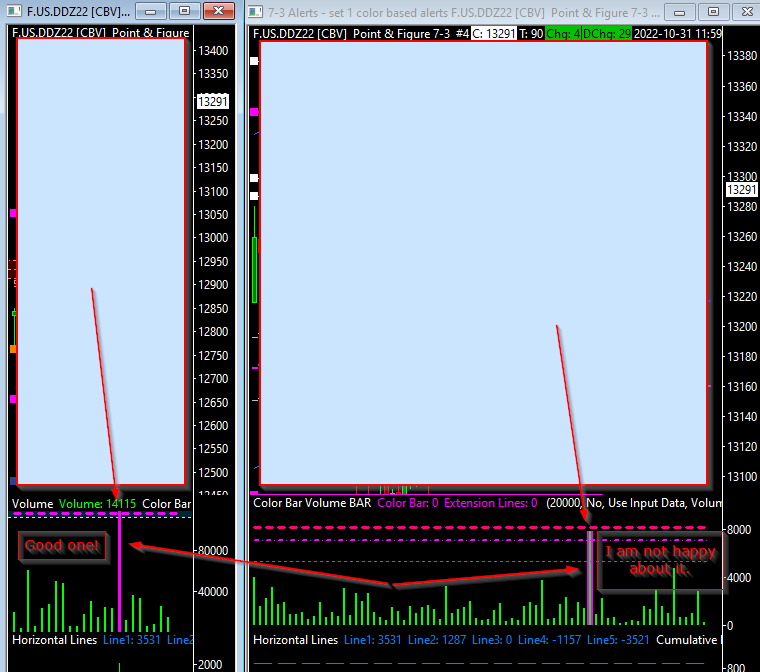

In general, I`ve managed to color bars but some of the color bars instead of being colored in full have only print color around the bar (just the border). What detail am I missing? I think I am doing everything the same, but still have the difference in coloring. Please see attachment.
Maybe I should provide more details? For instance, create a chartbook with these two charts so you can see the details?
imageColor Bar.png / V - Attached On 2022-10-31 12:09:51 UTC - Size: 51.64 KB - 365 views

[2022-10-31 17:39:14]
Did you set the Draw Style of the Color Bar Subgraph to be Bar so it matches the draw style of the subgraph you are coloring?
[2022-10-31 17:39:33]
Take a look at the setup for the Volume study collection we gave you.
[2022-11-01 12:10:36]
User266447 - Posts: 280
I have done exactly the same and have no idea why I cannot have the same results. I attached a printscreen and a chartbook. Thank you in advance for the detailed support.
imageColorBar 1.png / V - Attached On 2022-11-01 12:10:05 UTC - Size: 102.98 KB - 388 views

[2022-11-01 16:31:25]
You need to move the Color Bar Based on Alert Condition lower down in your list of studies. In particular, it needs to be below the Volume study so that when it is drawn it is drawn after the Volumes. Refer to the following:
Chart Studies: Study Display Order
