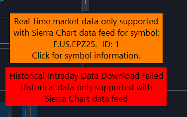

[2025-12-03 14:30:48]
User368916 - Posts: 1
A red message pops up for all my charts "Historical Intraday Data Download Failed Error downloading historical Intraday data for ESZ5.CME. permission denied" Any help would be much appreciated. Historical Intraday Data only supported with Sierra Chart Data Feed. But everything on my account is renewed. What could the issue be?
imageScreenshot 2025-12-03 092822.png / V - Attached On 2025-12-03 14:28:45 UTC - Size: 9.28 KB - 139 views
[2025-12-03 14:55:08]
The exchange that you had active in November did not renew on December 1, 2025, as you had insufficient funds in your account at that time for the renewal. Keep in mind that Sierra Chart does not have connectivity with CQG for data from the CME Group and EUREX, which is why you are getting those messages.
You need to add funds to your account and then you can activate the exchange(s) that you want at the following link:
https://www.sierrachart.com/UserControlPanel.php?page=DenaliDataFeed#Exchanges
