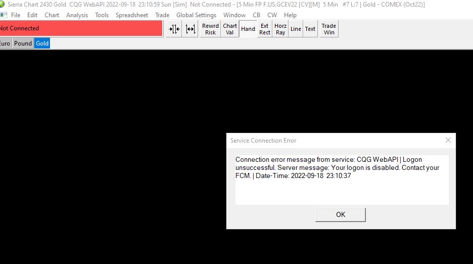

Im trying to connect CQG WEB API at Data/Trade Service Settings howeever however an error message appears (picture attached)
What should I do? Tried to use Denali data feed instead of CQG but its only working only for euro and pound futures, gold and es are delayed
imageCapturar2.JPG / V - Attached On 2022-09-18 23:29:37 UTC - Size: 45.9 KB - 307 views

Sierra_Chart Engineering - Posts: 25055
Refer to 12 here:
CQG Trading Platform Service: Common Error Messages
You should have no trouble accessing the real-time data independent of CQG . Go through these instructions below.
To access historical and streaming market data independent from your Trading service. Follow these instructions.
Set "Global Settings >> Data/Trade Service Settings >> Current Selected Service" to "SC Data-All Services".
Press "OK"
And then translate the symbols in your Chartbooks and Sierra Chart using this "Edit' menu command:
Edit Menu: Edit >> Translate Symbols To Current Service (Translate Symbols to Current Service)
You can then use the data provided by Sierra Chart independent of your trading service.

[2022-09-20 10:09:15]
We see that you are getting data up to the current time for that symbol:
HD Request # 14 | Received 3 Intraday data records from 2022-09-20 09:11:36.192000 to 2022-09-20 09:11:36.238000 (0.0 seconds) and wrote 0 records for GCV22-COMEX | 2022-09-20 09:14:48.685
If there is any missing data:
Re-download all the data in the chart by going to the chart and selecting "Edit >> Delete All Data and Download". You just need to do this once per symbol and not for each chart.
Also the most active contract at this time for gold is GCZ22-COMEX. This is what we recommend using.
If you have further issues refer to this help topic:
