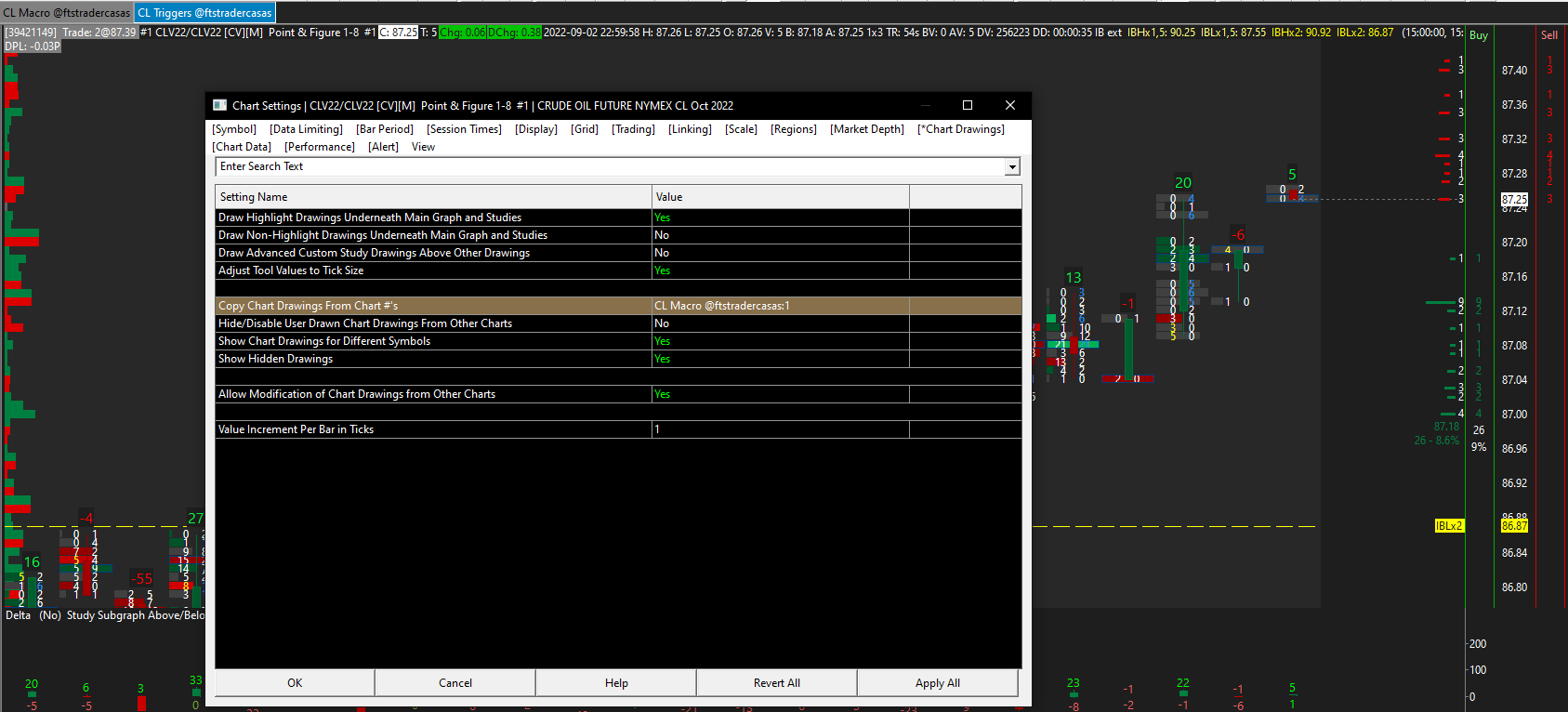

Drawings are shown correctly on my ES charts, not on my CL tough (see picture)
Settings are all the same, the symbol is set up correctly, I don't get it...
Which can be the reason for this?

John - SC Support - Posts: 48633
We do not know why you are having an issue with your CL Charts, but the one thing we want to point out is that you should not use special characters (like the @ sign) in your Chartbook names. We are wondering if this could be the reason for the issue.

[2022-09-08 17:27:52]
With regards to the drawing copying between chartbooks, this is working fine. The one thing we want to point out is that you need to look closely at the values where the drawings are located in the source chart and therefore where they will show up in the destination chart.
For example, with the CL chartbooks, you have chart #1 in the "CL Triggers @ftstradercasas" chartbook copying drawings from chart #1 in the "CL Macro @ftstradercasas" chartbook. "Chart #1 - CL Triggers" shows levels from 85.35 to 86.15 when the scales are reset for the current bars. In "Chart #1 CL Macros" the closest drawing is an extended ray at a level of 85.72. Relatively speaking, this is a long way above the current bars.
