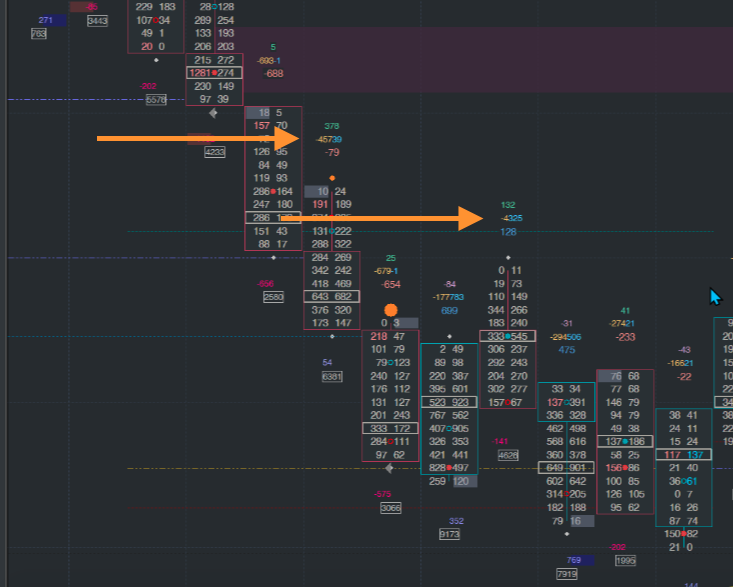

This is MIN Delta VOL +MAX Delta VOL.How can I write on top of each candle like the picture below?
image截屏2022-08-07 上午11.40.35.png / V - Attached On 2022-08-08 01:38:56 UTC - Size: 155.91 KB - 310 views

You would need to use the Numbers Bars Calculated Values to get the numbers themselves (you can hide the study if you do not want to see the table itself) and then use the Study Subgraph Above/Below Bar As Text study to put the information above/below the bar. Refer to the following information:
Numbers Bars: Displaying Numeric Information Below Numbers Bars
Study Subgraph Above/Below Bar as Text

Study Subgraph Above/Below Bar As Text can display a single MAX DELTA VOL or MIN DELTA VOL, but cannot display MAX+MIN on one line. This is very important.

Then you first need to add the values together and then you can use the Study Subgraph Above/Below Bar as Text. You can use either the Arithmetic Studies or the Spreadsheet Formula study. Refer to the information for each of these here:
Using the Basic Arithmetic Studies
Spreadsheet Formula
