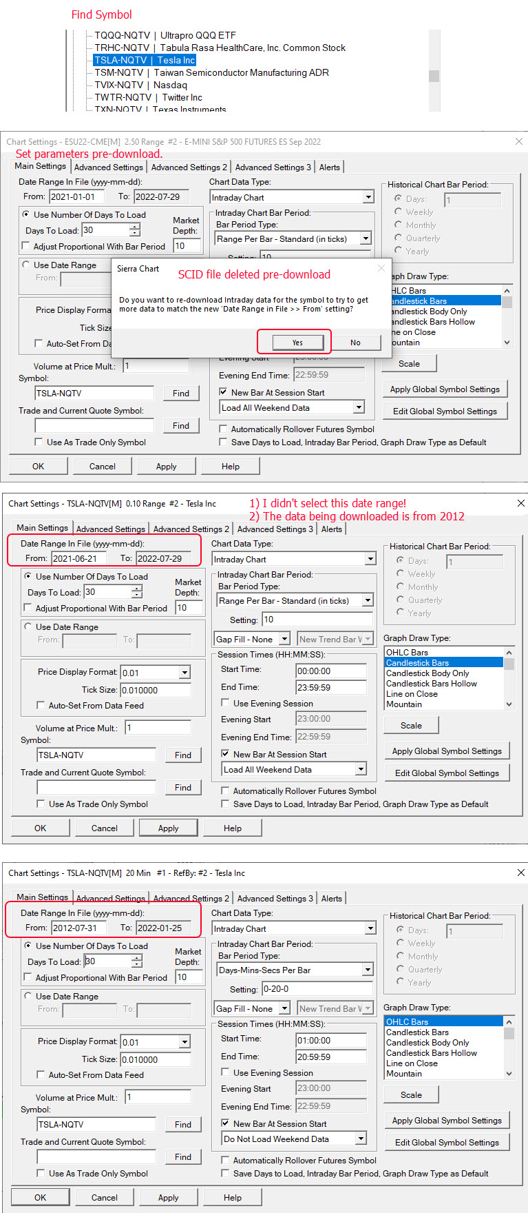

I cannot seem to correctly limit or select, the correct data parameters for, in this example Tesla.
I realise this is not my main platform (i.e., current SC version) but I cannot update this PC quite yet.
At this time I have various RT data feeds from Sierra but I wanted to run over some Stocks. In this instance I am trying to download Tesla but no matter what I do it downloads different date parameters.
Please see attached images.
I'm sure it's something I'm doing but I've not had issues in the past.
Many thanks.
imageSierra Data Download issue.jpg / V - Attached On 2022-07-29 17:51:18 UTC - Size: 580.11 KB - 261 views

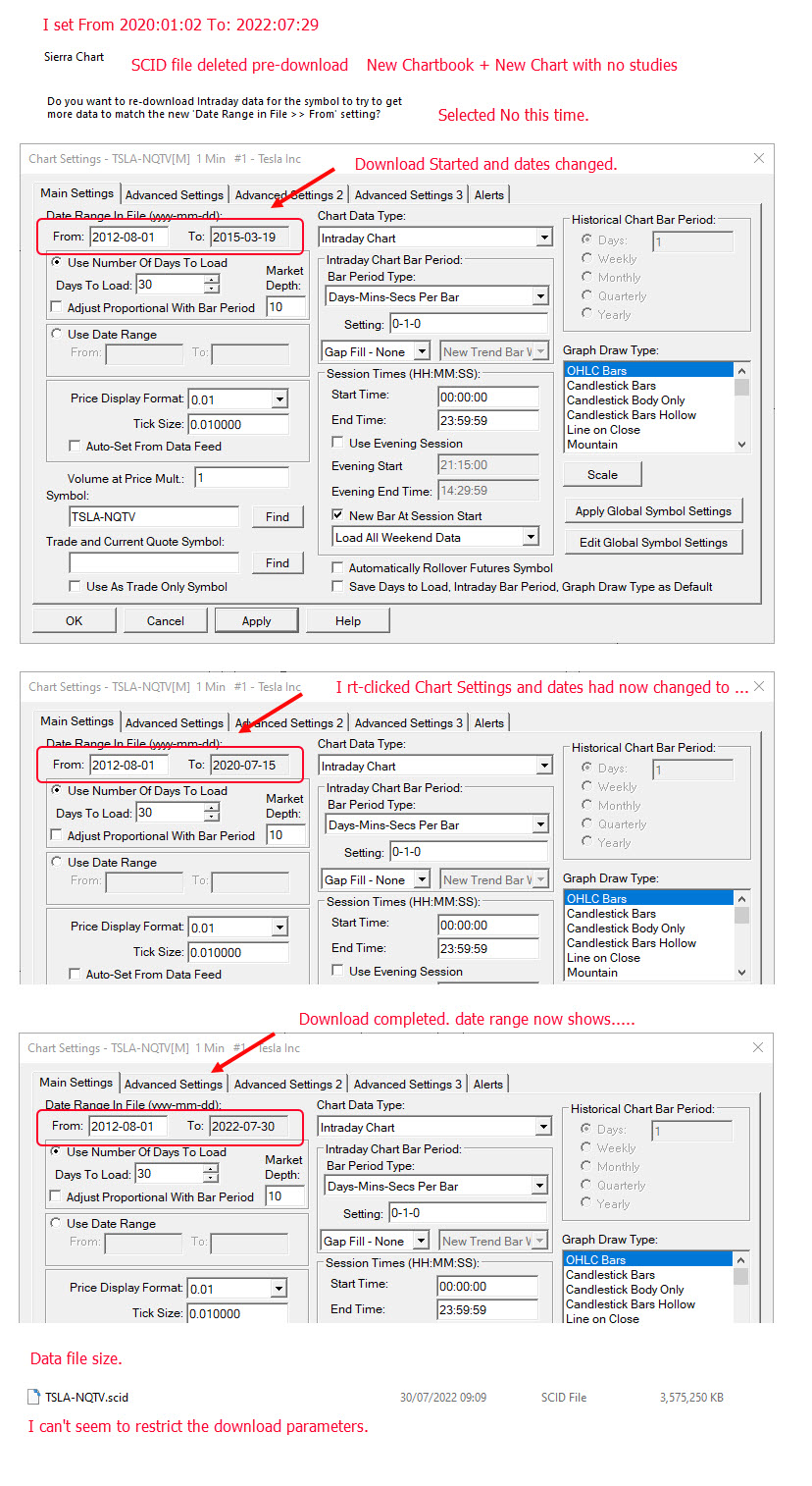

I've now re-run the download on both platforms this time with a new chartbook and single chart, no studies loaded and the .scid file deleted prior to restarting Sierra/downloading.
Both platforms, one using an older version and the other with V2416 both give me the same issue.
I've attached composite images taken on both platforms which I hope will help.
Many thanks.
imageSierra Data Download issue 2.jpg / V - Attached On 2022-07-30 09:02:47 UTC - Size: 475.79 KB - 290 views
imageSierra Data Download issue 3.jpg / V - Attached On 2022-07-30 09:02:55 UTC - Size: 522.69 KB - 252 views

Still not working as expected but here is a further update as I try everything I can think of.
Using the "Intraday data editor"
Go to Date-time
>> Date 2020-01-01
>> Time 00:00:00
Again using "Intraday data editor"
>> Delete and Download Data From Current Position to End "... Which should be the Go to Date-time but isn't"
Once again, it downloads the whole file back to 2012 approx. 3.57 GB
So, I've run out of things to test. I just cannot seem to restrict the Intraday download to encompass 2020-01-01 to current data/time.
That's it in a nutshell - no images just an explanation of my ongoing attempts to solve this.
Please show me where exactly I am going wrong. If it's paid support so be it but I need a specific solution not just a hyperlink.
Many thanks.
