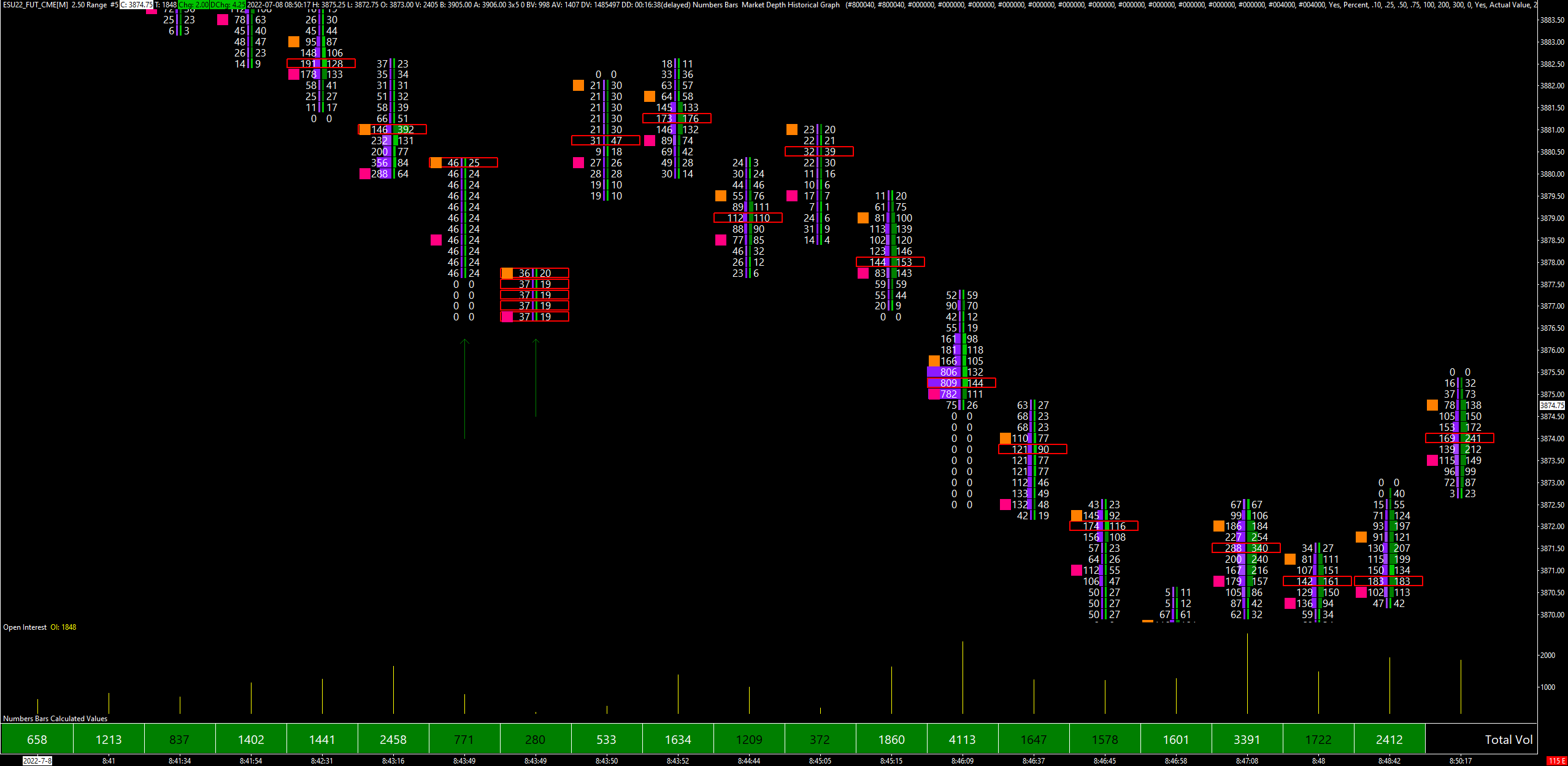

I am comparing the output of a Numbers Bars study with a friend of mine, and our output looks markedly different. We both are on Denali CME and Teton, both set to intraday data storage at 1 tick. The only difference I can see is that he has MBO and I do not. I don't know if that impacts the numbers bars study or not.

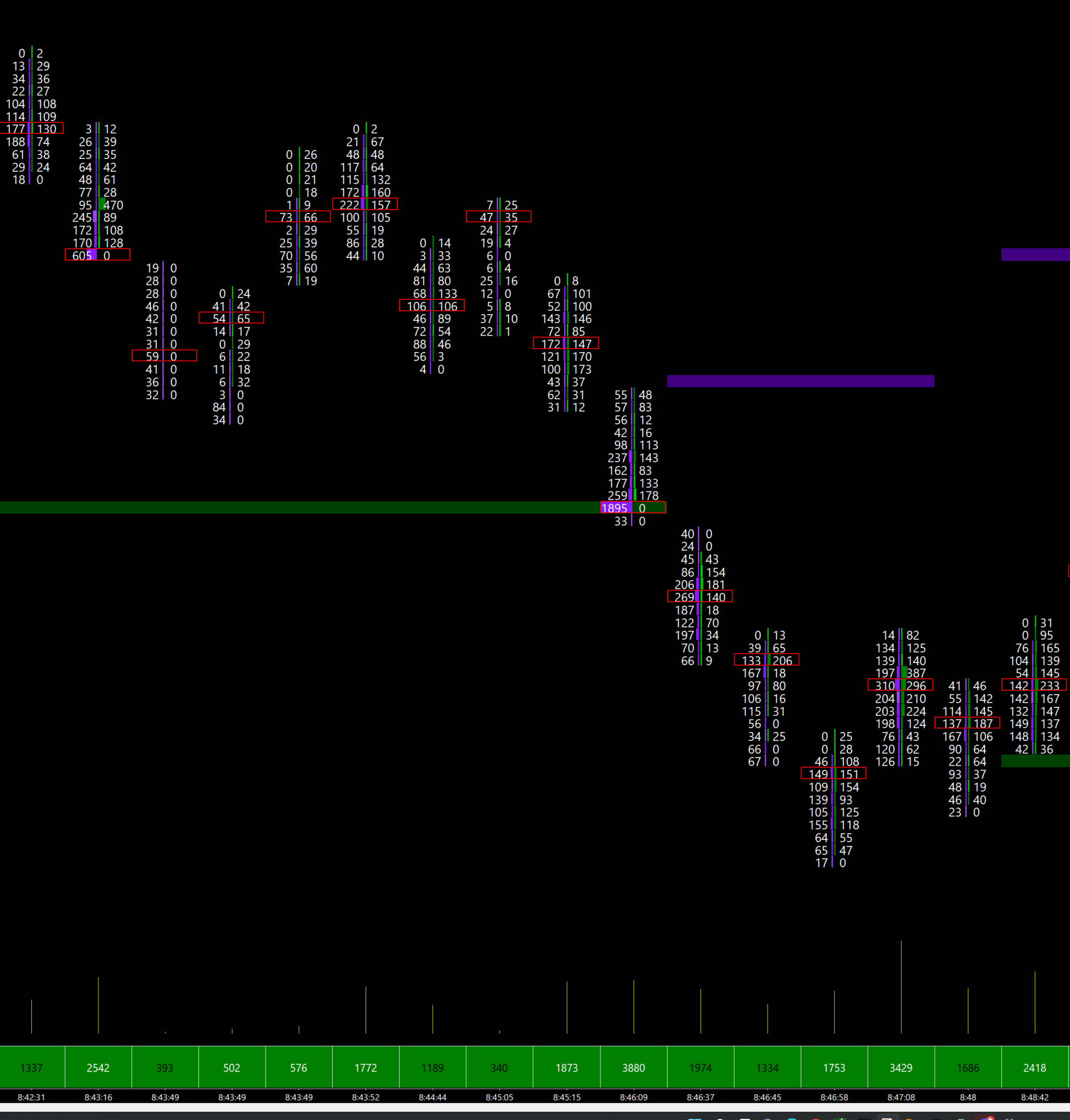

The attached examples are from 7/8. Look at the bars at 8:43:49. His view does not have the long tail of zeros and the next block with five matched-volume pairs. Note that I had to add his as an image as I do not have access to his SC instance.

There must be some reason for the difference. Are you sure that each instance of Sierra Chart is set to a tick by tick data configuration?
Set Sierra Chart to a Tick by Tick Data Configuration. Follow the instructions here to do this:
Also refer to:
Working With Charts: Resolving Differences of Chart Bars Between Charts
