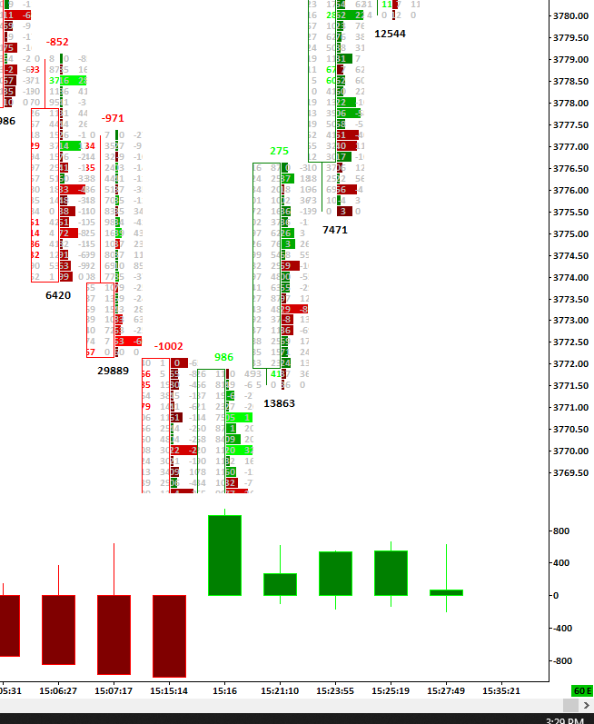

countryboy92 - Posts: 119
for Number 1, it works, but how do I make my bars wider so I can see all the numbers?
imageFootprint with Numbers Bar.PNG / V - Attached On 2022-06-30 19:34:34 UTC - Size: 55.29 KB - 550 views

John - SC Support - Posts: 48028
Refer to the following:
Numbers Bars: Scaling a Numbers Bars Chart
A couple questions:
1. Please see attached. I got it working, but a) how do I get rid of the ".00" in my bid/ask variance at the top of each bar? b) How do I remove the "0" on top of each bar.

[2022-07-01 14:57:42]
I fixed the decimals. Here's my file and there is a "0" displaying at the top of each candle and I can't find the source.

[2022-07-01 15:30:50]
It is coming from the study named "Delta" which is a Study Subgraph Reference study, but is pointing to a non-existent subgraph.
