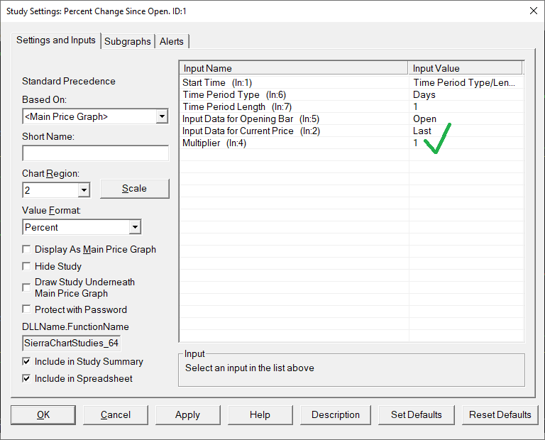

[2022-06-29 21:51:57]
DCSaba - Posts: 124
So 1) the Mutiplier stays 1. That's ok (see picture attached).
And 2) I can use and Arithmetic Study to multiply this %-Change-Study.
But where do I get the 'CurrentPeriodOpenValue' in the hyopthetical formula above?
imagePercentageStudy.png / V - Attached On 2022-06-29 21:50:52 UTC - Size: 27 KB - 241 views
