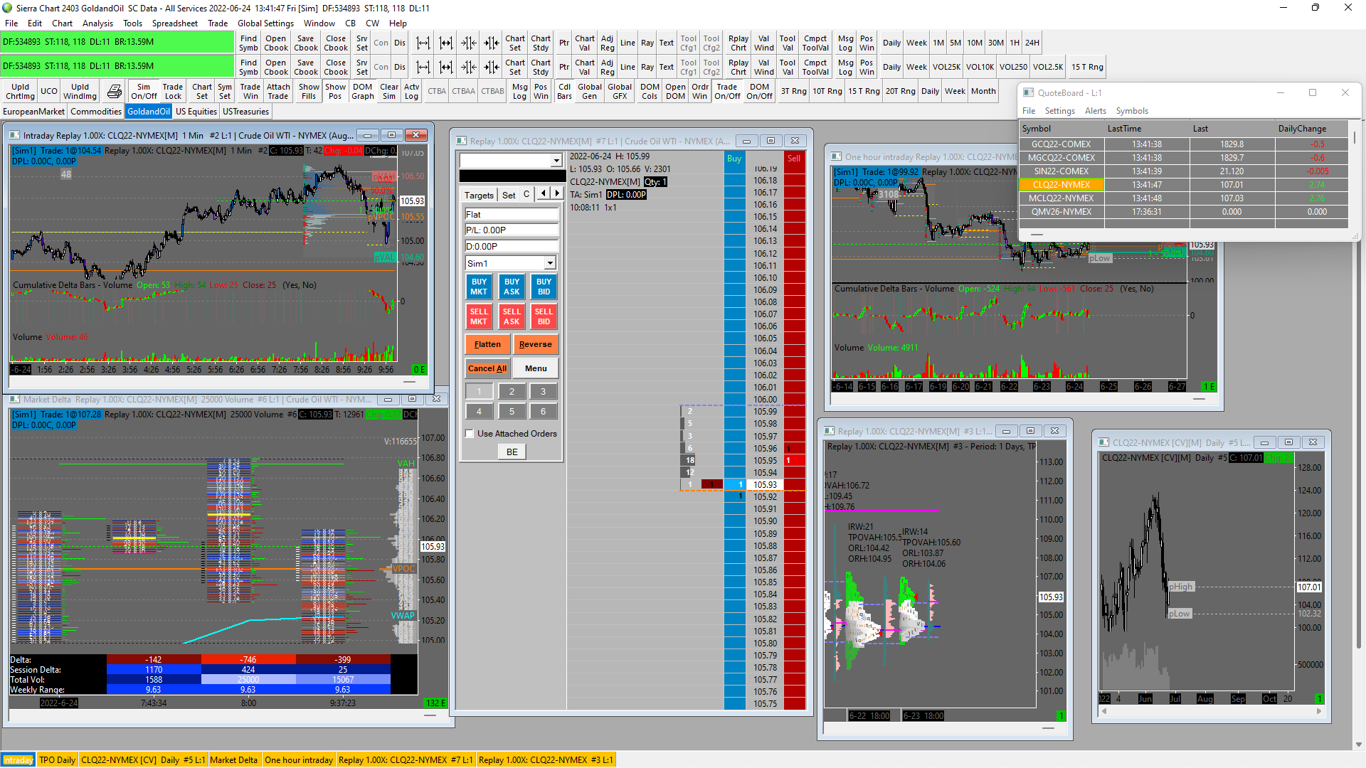

Replay works fine on my laptop including DOM from the historical data. I am migrating from one instance to another on my desktop.
Upon opening new instance, all my commissions and settings in global symbol settings are set back to default. Maybe I missed something. I did follow documentation seems doc. maybe for an older version.
But my purpose in the new instance is to have a replay outside of my trading evaluator. I have set the data/trade setting down to one tick and the Global Symbols Settings I have set it to enable saving of market depth.
When I replay it doesn't include it in the DOM. Could be missing something. I have done this successfully before.
See DOM in replay screenshot. Point me in the right direction. GREAT PRODUCT. Cannot say enough about it.
imageimage_2022-06-24_134932652.png / V - Attached On 2022-06-24 17:49:39 UTC - Size: 271.28 KB - 358 views
[2022-06-24 20:25:27]
John - SC Support - Posts: 48074
Typically, with the Trade DOM the issue is that you do not have the number of days loaded to match to the charts. Refer to the following:

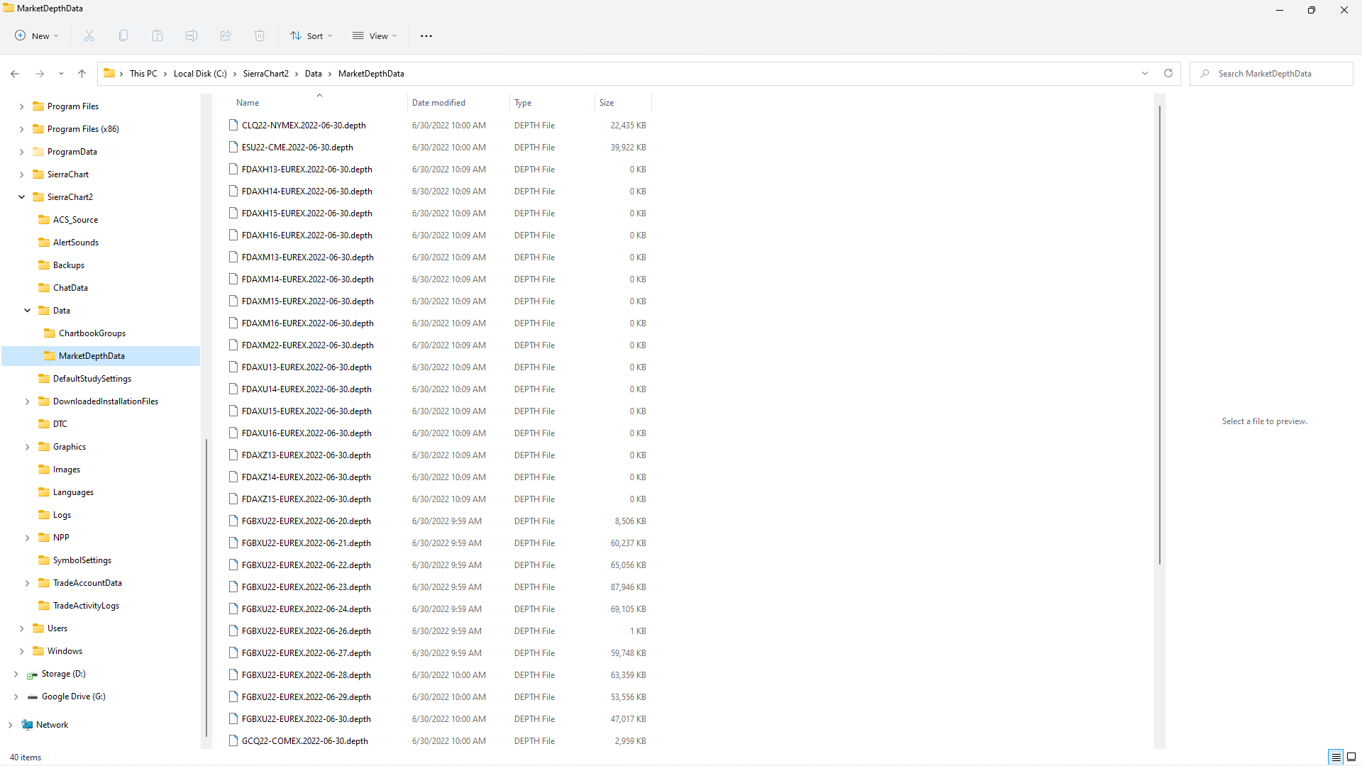

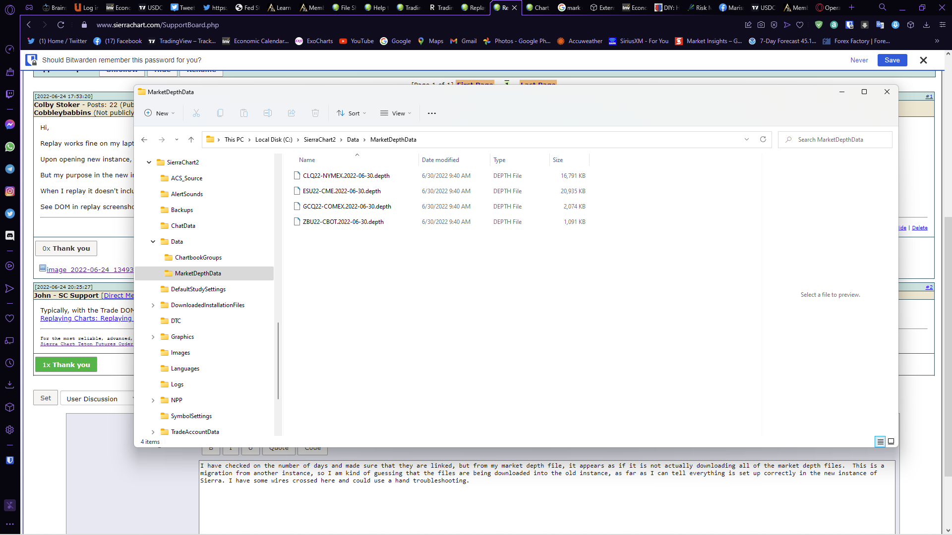

I have checked on the number of days and made sure that they are linked, but from my market depth file, it appears as if it is not actually downloading all of the market depth files. This is a migration from another instance, so I am kind of guessing that the files are being downloaded into the old instance, as far as I can tell everything is set up correctly in the new instance of Sierra. I have some wires crossed here and could use a hand troubleshooting. I have included a screenshot of the marketdepth folder and I have checked to ensure that the path for the data file is correct for each instance.

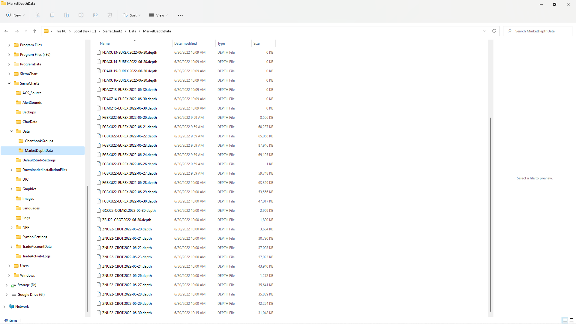

Colby Stoker - Posts: 31
So, now I have one symbol that works for Replay, ZN which it appears to be downloading the market depth data correctly and replays correctly.
The other symbol FGBX appears to be downloading but does not play in the replay with correct DOM.
Other symbols such as FDAX appear to not download market depth data correctly,
ES, GC only load one days worth of data. See attached file.
Let me know if you want to see my message log.
