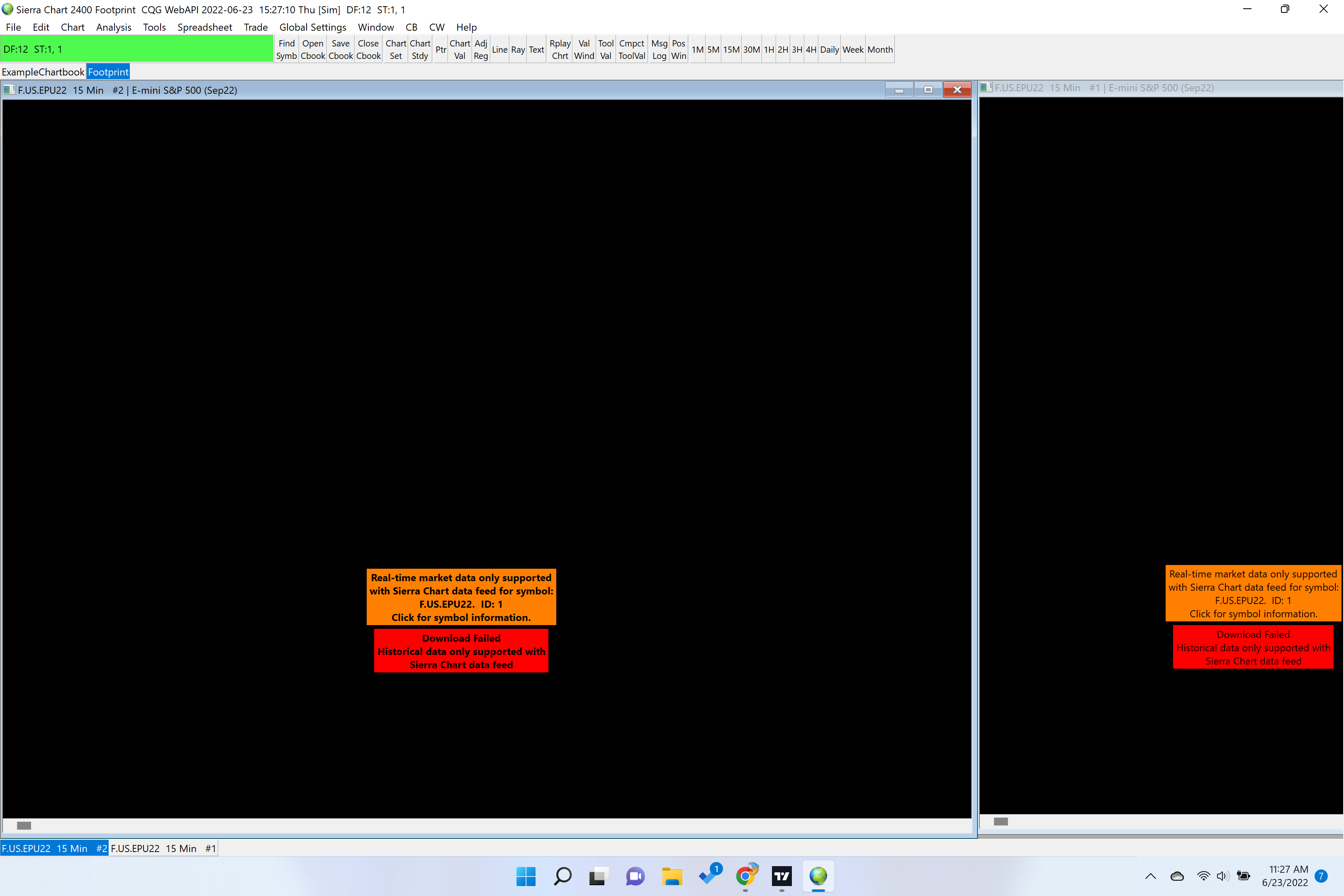

timobee - Posts: 3
I'm in the same boat here. Just getting set up and I have linked AMP via CQG(No Data - Order Routing Only) which appears to be connected, and I have Allow Support For Sierra Chart Data Feeds selected to "Yes". I have just purchased service package 12 Denali advanced MBO but can't seem to get data connected (I have tried disconnecting and connecting again)
Hoping you can help please!
Thank you

[2022-06-23 16:42:53]
John - SC Support - Posts: 48539
Everything looks good, so we do not know off hand why you would be having an issue. Get us your Message Log by following these instructions:
Open a chart for the symbol you have an issue with. Tell us that symbol of the chart.
