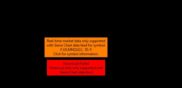

My account is still showing following error (see attached picture). Can not download the data for CME symbol.
Please advise.
imageScreenshot 2022-06-16 105049.jpg / V - Attached On 2022-06-16 16:53:22 UTC - Size: 17.1 KB - 290 views
[2022-06-16 18:29:10]
With version 2394 and higher we are no longer allowing CQG data from the CME Group and EUREX into Sierra Chart. Refer to the information here:
https://www.sierrachart.com/index.php?page=doc/Whats_New.php#SCVer2394
Given this, you can either:
1) Downgrade to version 2393. Refer to the information here:
Software Download: Full Control Rollback Procedure
or
2) Use our Denali Exchange Data Feed. In so doing, you can tell AMP that you do not need the data from CQG, so it will essentially cost you the same amount. Refer to the information at the following link which also includes Setup Instructions:

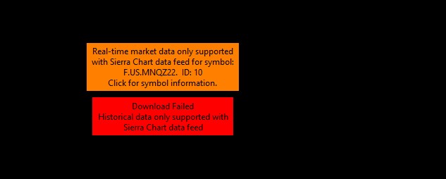

Option 1: worked , which is using 2393 version
Option 2: latest version with Denali data feed is not working. Currently I am on evaluation package 12 but still see the same error message.
imageScreenshot 2022-06-16 123956.jpg / V - Attached On 2022-06-16 18:44:20 UTC - Size: 78.5 KB - 286 views
imageScreenshot 2022-06-16 124054.jpg / V - Attached On 2022-06-16 18:44:27 UTC - Size: 17.81 KB - 300 views
[2022-06-16 19:12:52]
With option 2 you need to go through the Setup Instructions for the real-time data, as you need to fill out forms and activate exchanges. For the CME Group data, then instructions are at the following link:
We should also point out that with the CQG data, you can not get data for a prior contract, therefore you can not put together a Continuous Futures chart.
With the Denali data, we have data for the CME Group going back to 2011.
