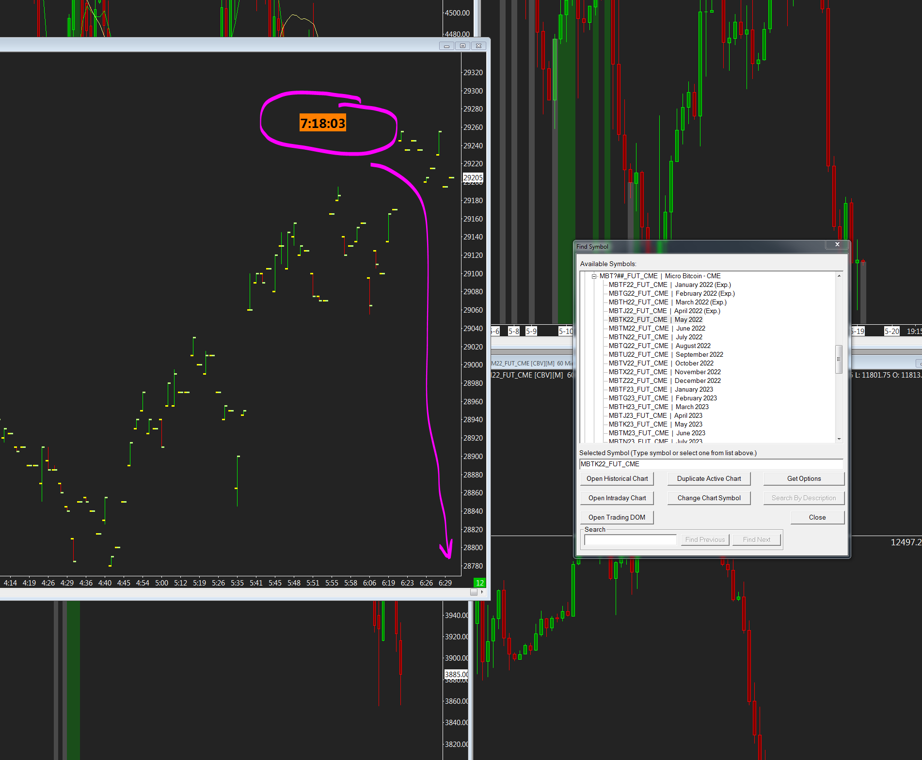

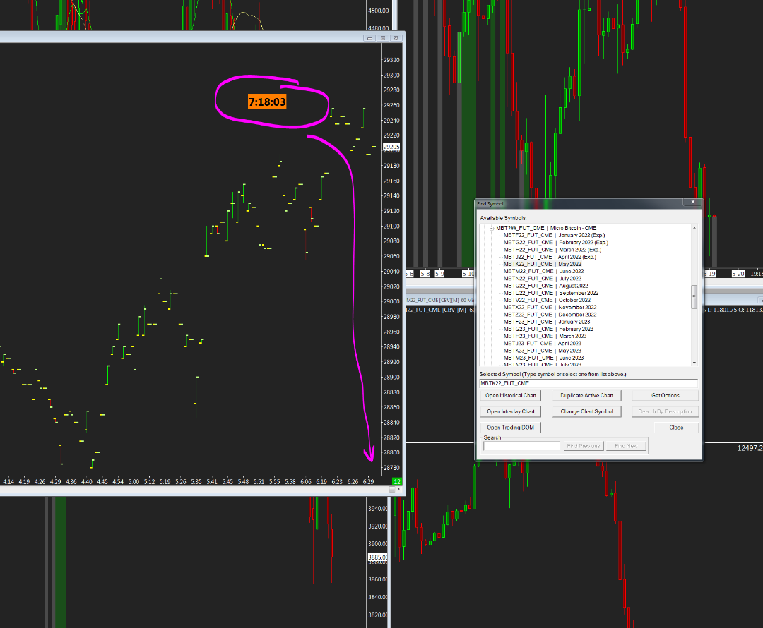

I am having an issue with getting MICRO btc data. I asked edgeclear to enable my being able to trade it and all is in place with their system. There appears to be a data issue with you/cme but as you can see from the enclosed photo when I call up a chart the data is delayed by an hour. Also when I call up a dom you will see the notice given. Please advise Edgeclear and I get my account able to receive data and trade micro btc futures on cme.
thank you
imagembt.PNG / V - Attached On 2022-05-19 13:10:54 UTC - Size: 190.2 KB - 254 views
imageDATAOFF.png / V - Attached On 2022-05-19 13:11:07 UTC - Size: 137.05 KB - 237 views
[2022-05-19 14:11:19]
John - SC Support - Posts: 48563
The reason you are getting the delayed data for the Micro Bitcoin (MBT) is because the exchange that you have activated for the Denali Exchange Data Feed does not include that symbol. You have activated the CME E-Mini for Professionals and Users without a Trading Account. In order to get the MBT data you would need to activate the CME, For professionals and users without a trading account exchange. You can make changes to your exchange options at the following link:
[2022-05-19 14:22:59]
User849502 - Posts: 485
I see tho even tho it is a micro btc they make you pay the full whack cme fee??
[2022-05-19 15:14:10]
We need to check on that. Do not make any changes at the moment. We are going to check on this.
[2022-05-19 15:23:13]
Looks like we can include the Micro Bitcoin contract with the CME e-mini exchange fee. This will require a software update which we can do probably as soon as this evening.
[2022-05-19 15:26:58]
Actually we can get this released in about 45 minutes. At that time you will just need to reconnect to the data feed:

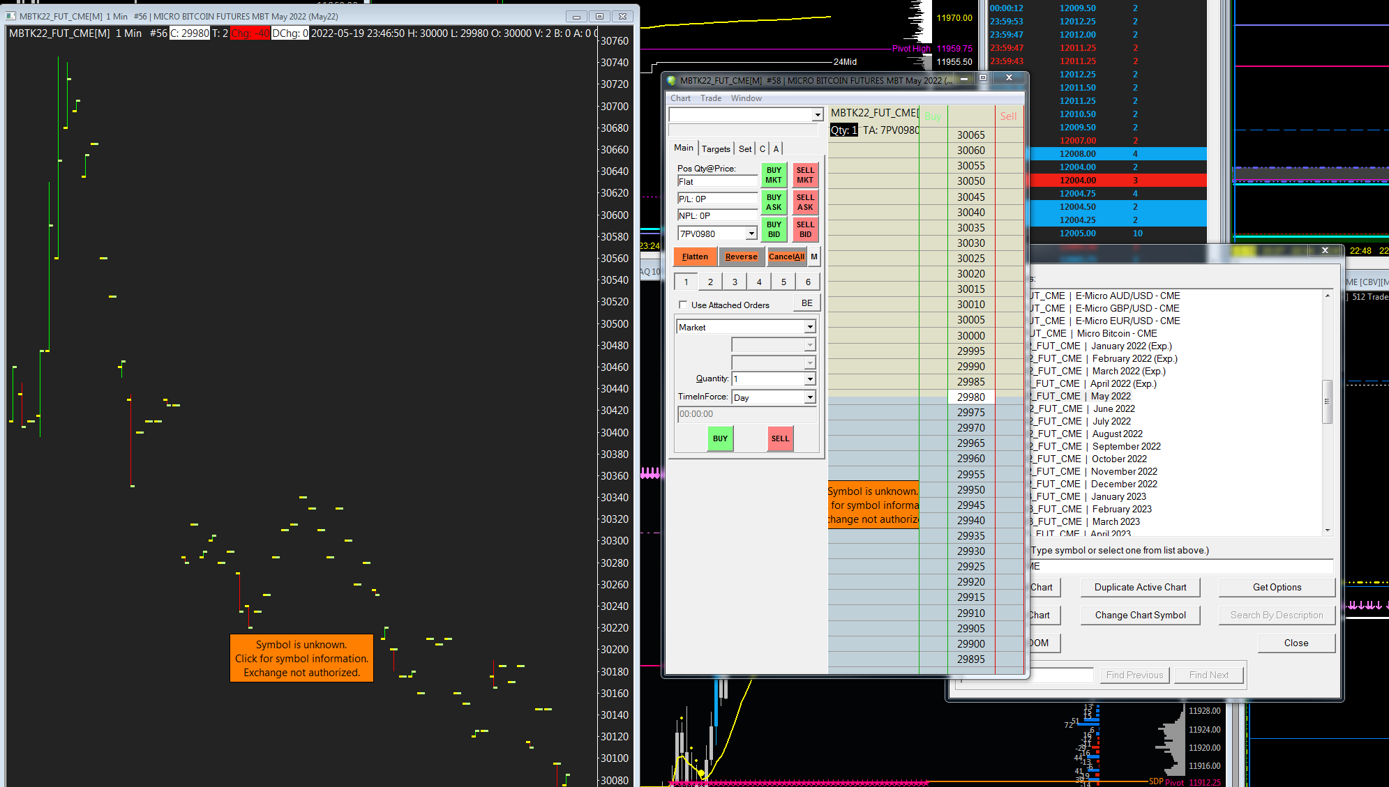

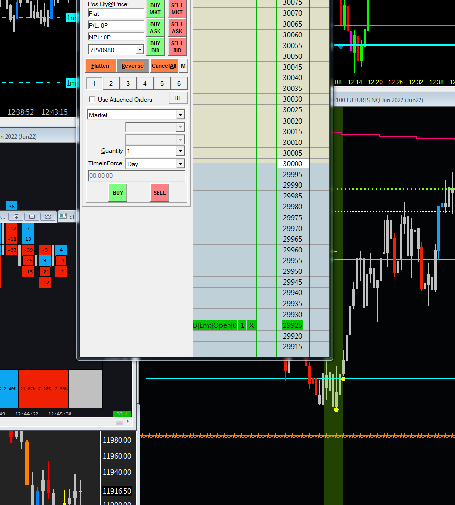

[2022-05-19 17:52:05]
Hi Guys,
It's getting a bit better, in that I could enter an order(but don't think it was really in there) as there is no volume in bids or offers.
I have disconnected and reconnected data, and I have logged off and back on.
What do you advise please? See attached screenshot
imagembt2.PNG / V - Attached On 2022-05-19 17:51:57 UTC - Size: 85.66 KB - 254 views
[2022-05-19 18:31:25]
Sierra_Chart Engineering - Posts: 25436
Reconnect to the data feed:

Symbol Error - MBTK22_FUT_CME is unknown, unavailable, or improperly formatted. Exchange not authorized. | 2022-05-19 23:56:33.473

SC Data - All Services | Market Depth data has been rejected for symbol: MBTK22_FUT_CME. Exchange not authorized. | 2022-05-19 23:56:37.349
Symbol Error - MBTK22_FUT_CME is unknown, unavailable, or improperly formatted. Exchange not authorized. | 2022-05-19 23:56:37.350
SC Data - All Services (Market Orders Data) | Market Orders data has been rejected for symbol: MBTK22_FUT_CME. Exchange not authorized. | 2022-05-19 23:56:37.351

imagembt3.PNG / V - Attached On 2022-05-20 05:02:14 UTC - Size: 225 KB - 241 views
[2022-05-20 05:03:38]
i hope this is right I did exactly as you said. I have also sent screenshot of how SC is telling me symbol unknown and exchange not authorised.
THANK YOU
[2022-05-20 08:39:30]
We are checking on this.:
[2022-05-20 09:02:22]
just to make clear as I see above 'sc data all services' I have that on my second computer(which I pay the 2nd exchange fees for) but the computer that Edgeclear allows me to trade has Teton data feed. It is from this computer 'Teton' that I have been sending you screen shots and can't get the micro btc charts or dom on. I have two feeds as the chartbook Fleri from OFL tool uses to chart btc is based on the perp contract. Sorry if this is not info you need, but just trying to help you.
