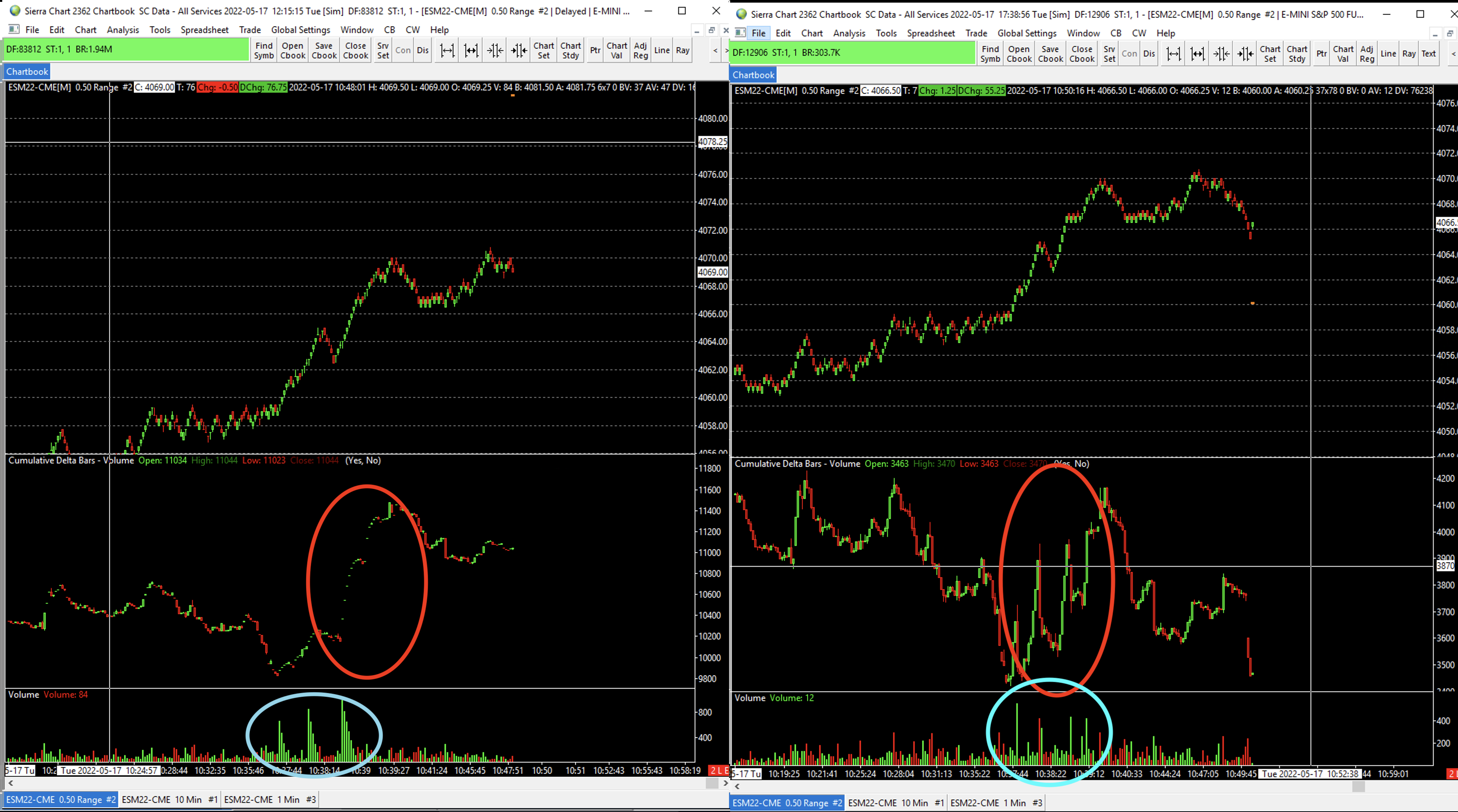

I have an issue with data quality that I can't seem to resolve.
I used your trial for a couple of days to evaluate the Denali Data Feed. Once I saw what great quality it was and what trade opportunities I can generate with it, I subscribed to Service Package 10 on Thursday last week.
On the Thursday, Friday, and yesterday, I noticed, however, that the volume and cumulative volume delta data I am getting "feel" different. Namely that during some topping/bottoming patterns I do not see any algorithmic behaviour anymore.
Fortunately, I had the trial instance still running on a different virtual machine to where I am running the new paid instance with Service Package 10 (I changed to a different VM because of Interactive Brokers port requirements). So, this morning, I was able to compare the 2 data sets side-by-side: and sure enough the data on the trial instance (VM) was nice and clean whilst the data on the Service Package 10 instance (VM) was somehow corrupt. I thought that this could be due to the paid instance VM having some other ports closed and the data download from SC thus being incomplete.
So then I thought that I would just open the ports on the trial VM to enable Interactive Brokers working there and be done with it. I then logged in to the trial VM with my paid account but then I saw again that the data is somehow different.
I then made sure to take screenshots (unfortunately I cannot upload it in the way that you require in the Add/Edit Attached Files popup window, because the old clean data is now gone) of the difference between the trial VM to the paid VM data (the two screenshots are side-by-side in the attached image). On the left is what the data used to look like and on the right is what it is now. I tried to "Delete and Download Data" to see if it fixes the problem, however, it only made all of the nice and clean historical data disappear and I now have the "corrupt" data everywhere, with no signs on algorithmic behaviour.
I am not sure if I am clear enough, though I really tried hard to phrase this as clearly as possible.
Could you please help me out? I could not find a similar issue anywhere on the board and I am getting really desperate.
Thank you in advance!
Tomas
imageScreenshot 2.png / V - Attached On 2022-05-17 15:45:24 UTC - Size: 1.73 MB - 384 views
[2022-05-17 16:36:02]
The only thing we can say is that the data on the right matches to what we see. Therefore, the data from the image on the left is the one that is questionable, but since that data is no longer available, we have no idea why the Cumulative Delta Bars - Volume are different.
