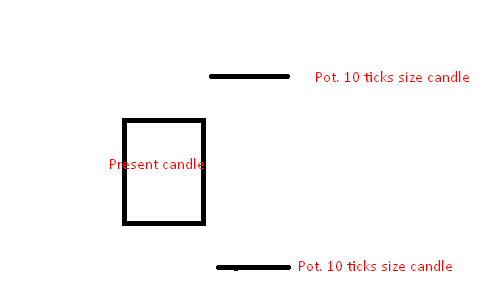

Is there a tool which would show me where is e.g 10 ticks from High and low for present candle?
imagecandle.png / V - Attached On 2022-05-05 14:31:51 UTC - Size: 4.32 KB - 236 views

You would need to use the Arithmetic studies to do this. Refer to the following:

From what you posted, you wanted to put a line 10 ticks above the High (maybe Open/Close) and 10 ticks below the Low (maybe Open/Close). To do this for the High (for example), you would use the Study Subgraph Add study and use the High for the Input Data and enter the amount of offset for the line in the Amount to Add - for example 2.5 for 10 ticks of an instrument with a tick size of .25 (you are entering price values in this case).
This will give you a line at the high of each bar plus 2.5. To get it just on the last bar and to the right edge, change the Draw Style for the subgraph to Line at Last Bar to Edge. Refer to the information here:
Chart Studies: Line at Last Bar to Edge (ACSIL: DRAWSTYLE_LINE_AT_LAST_BAR_TO_EDGE)
