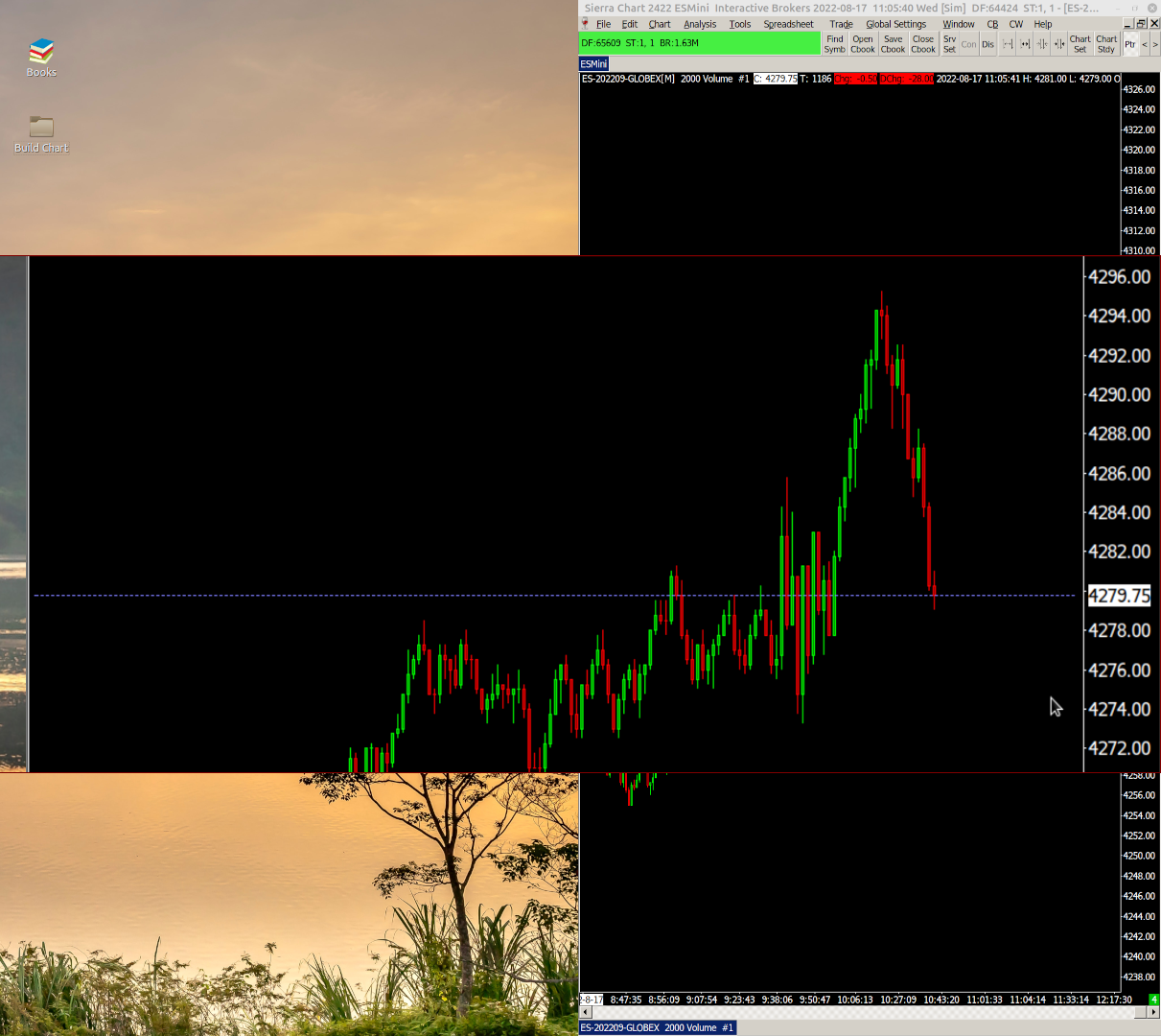

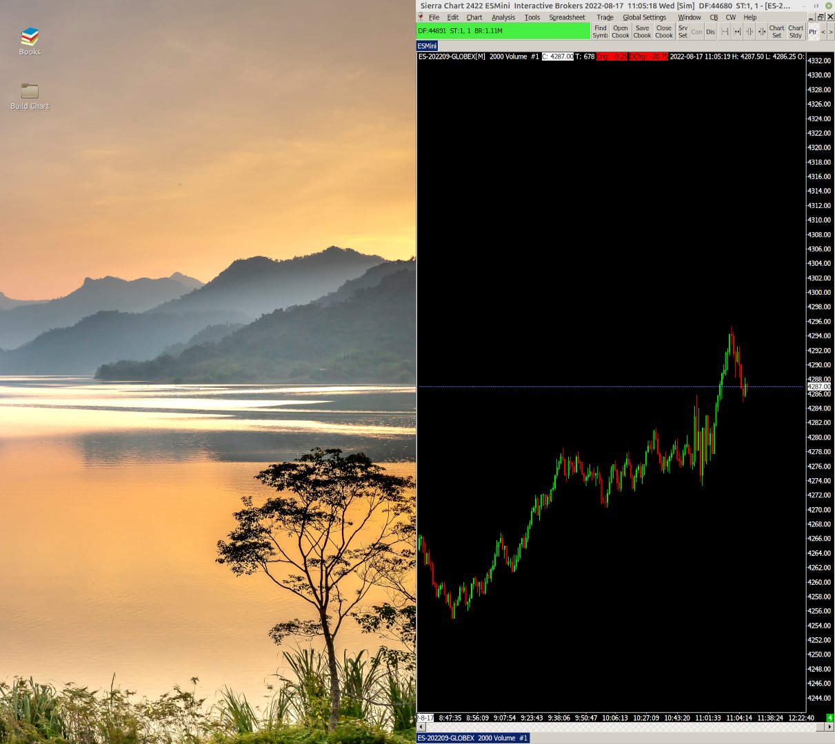

Tony - Posts: 732
OS's Accessibility features might meet your need. Here is an example of Linux Mint, attached 2 screenshots showing how it looks like before and after zooming. Mac OS has that feature too, not sure about Windows.
imageNormal.png / V - Attached On 2022-08-17 18:13:41 UTC - Size: 1014.14 KB - 348 views
imageZoom.png / V - Attached On 2022-08-17 18:13:56 UTC - Size: 624.71 KB - 377 views
