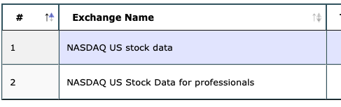

Few more questions if you can oblige.
1. I see there is a discount for buying SC package in bulk of >3 months. Does the market depth also provide a discount when buying in bulk?
2a. I need live stocks data with TPO VP enabled. Do I just buy the NASDAQ feed since I already have package 11? What about the stocks listed on NYSE?
2b. As my stocks account is with Tdameritrade and SC does not support it, is there still a need to login once a month in some broker that is supported by SC's connection?
imageScreenshot 2022-04-27 at 12.18.32 AM.png / V - Attached On 2022-04-26 16:21:39 UTC - Size: 21.62 KB - 277 views
[2022-04-26 16:54:54]
John - SC Support - Posts: 48273
1. The exchange fees are not available to be bought in multiple months. Even if we did, they would not be discounted, as the exchanges do not offer this option.
2. The NASDAQ TotalView exchange includes data for NYSE stocks.
3. The NASDAQ TotalView exchange does not have a requirement to login to a live account. That is only a CME Group requirement.
