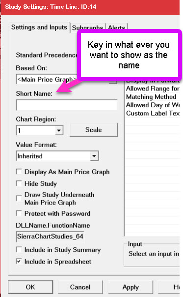

[2022-04-21 12:17:14]
JohnR - User831573 - Posts: 340
Maybe this is what you are looking for.
Chart Studies: Study Settings Window
Settings and Inputs Tab >> Short Name
Use the Short Name setting to give a study a short or custom name to display as an alternative to the default study name in the Region Data Line for the chart region where the study is located on the chart and to display in the Chart Values windows.
JohnR
imageStudy short name.jpg / V - Attached On 2022-04-21 12:16:39 UTC - Size: 59.56 KB - 246 views
