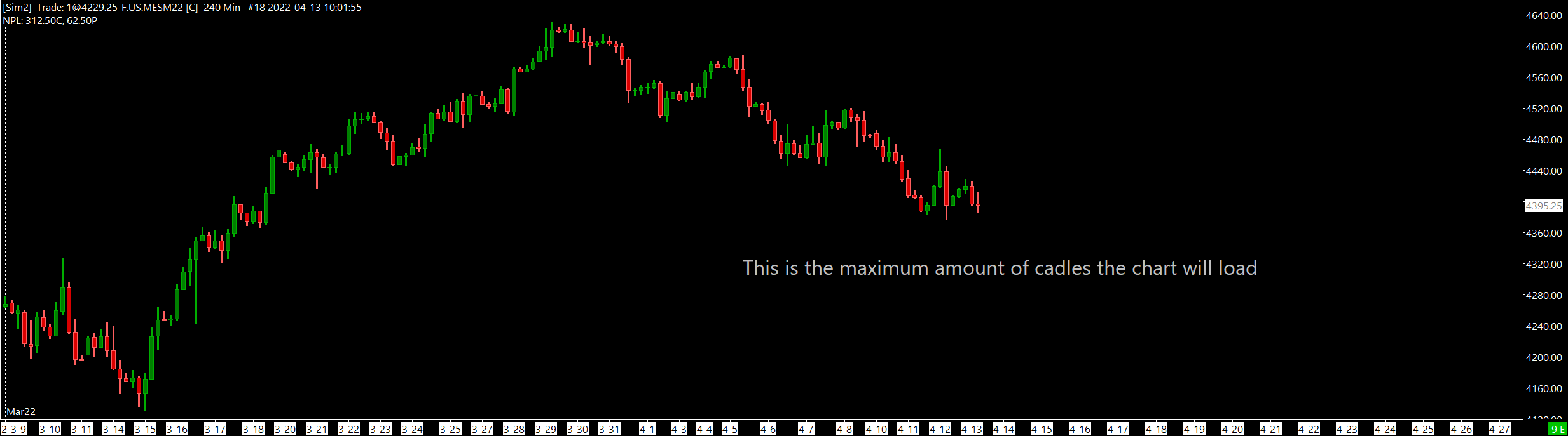

[2022-04-13 13:43:42]
Provide an image of the chart showing the issue, by following these instructions:
Scroll the chart to the very beginning and take an image of it.
Date Time Of Last Edit: 2022-04-13 13:44:01
[2022-04-13 14:05:04]
User871209 - Posts: 99
Here is link:
https://www.sierrachart.com/image.php?Image=1649858573310.png
Something changed from when I did this procedure and I am now losing connection every about 5 minutes, it connects again, and then I have to wait till the charts start moving again another couple of minutes. All morning their was not a problem and I have not changed any settings for it to be going and disconnecting, it is on a loop like this.

John - SC Support - Posts: 48369
Both of your issues are related to the fact that you are using CQG data. The solution to both is to use the Denali Exchange Data Feed.
CQG only provides a limited amount of historical data, and they do not provide anything for previous contracts. The Denali Exchange Data Feed has 1 tick data back to 2011 for the CME Group data.
Also, in order to display the data going further back, you will need to use a Continuous Futures Contract Chart. Refer to the information here:
Continuous Futures Contract Charts
With regards to the connectivity, there has always been issues with connectivity to CQG. Refer to our information here on this:
CQG Trading Platform Service: Frequent Server Disconnections when Using CQG
When using the Denali Exchange Data Feed, it is our data feed and maintained by us, so you know we will do our best to ensure good connectivity.
For more information on the Denali Exchange Data Feed refer to the information at the following link, which also includes Setup Instructions:
