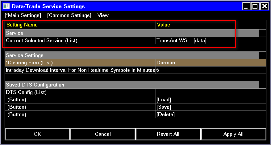

[2022-04-04 09:10:33]
The data is still delayed.
You must not have connected to Transact in in version 2353 or earlier.
And Transact WS is absolutely listed in all versions. Refer to the attachment. In versions 2353 or earlier, you will see [trading] after the name "Transact WS".
imageTransactServiceSetting.png / V - Attached On 2022-04-04 09:07:58 UTC - Size: 10.87 KB - 378 views
[2022-04-04 09:49:33]
User957321 - Posts: 29
That is correct Transact WS/data is listed but not trading. I connected to WS/data and it did not work. There is no reference to trading in that drop down menu. Is there another version to be used?
[2022-04-04 11:01:39]
Right but for the Trading connection you need to use an earlier version 2353 or earlier.
We recommend that you install another installation of Sierra Chart just for this purpose of connecting to Transact once a month:
Using Multiple Data and Trading Services at the Same Time: Step-By-Step Instructions to Install Multiple Copies of Sierra Chart
Date Time Of Last Edit: 2022-04-04 11:02:21
