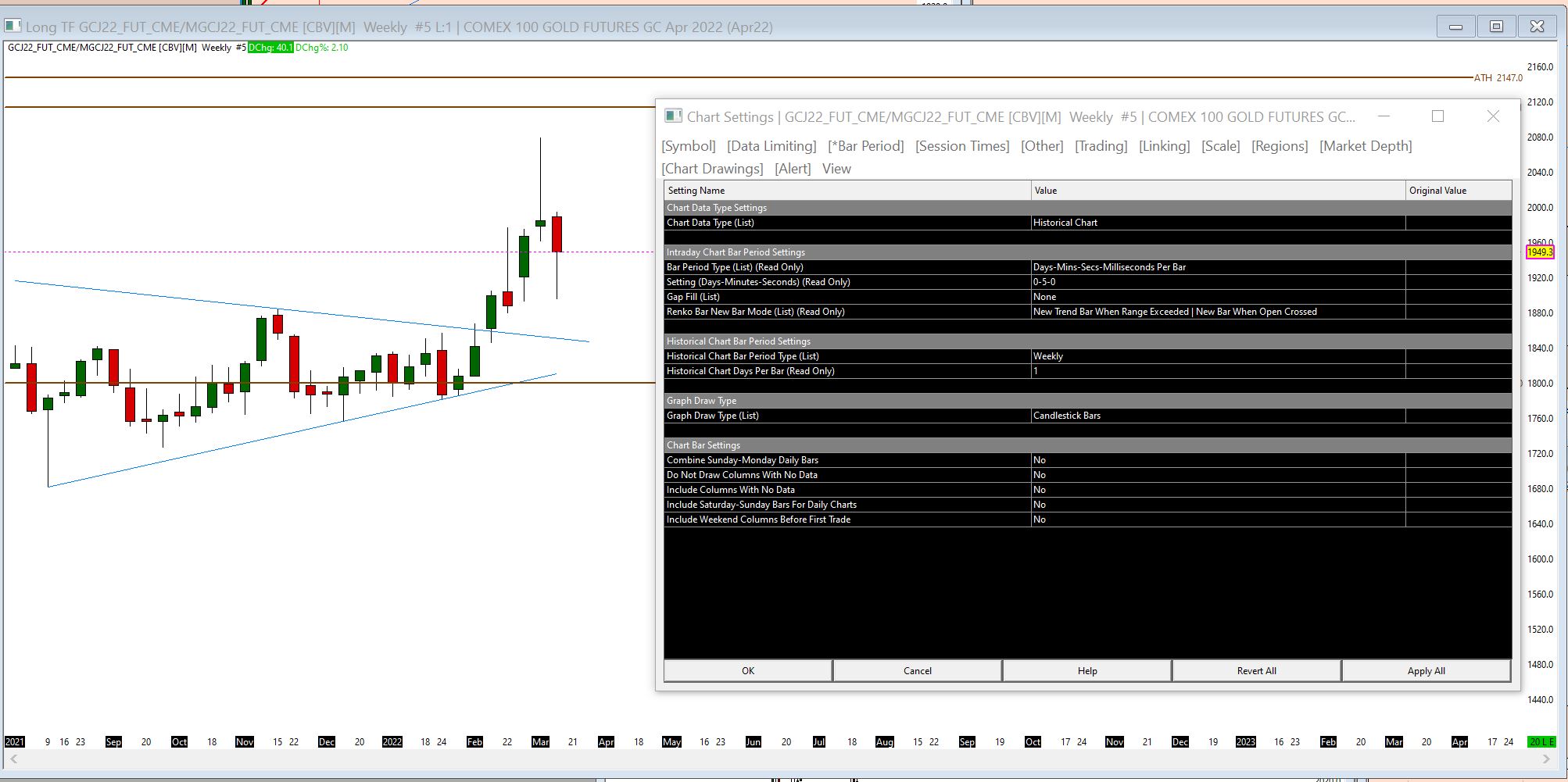

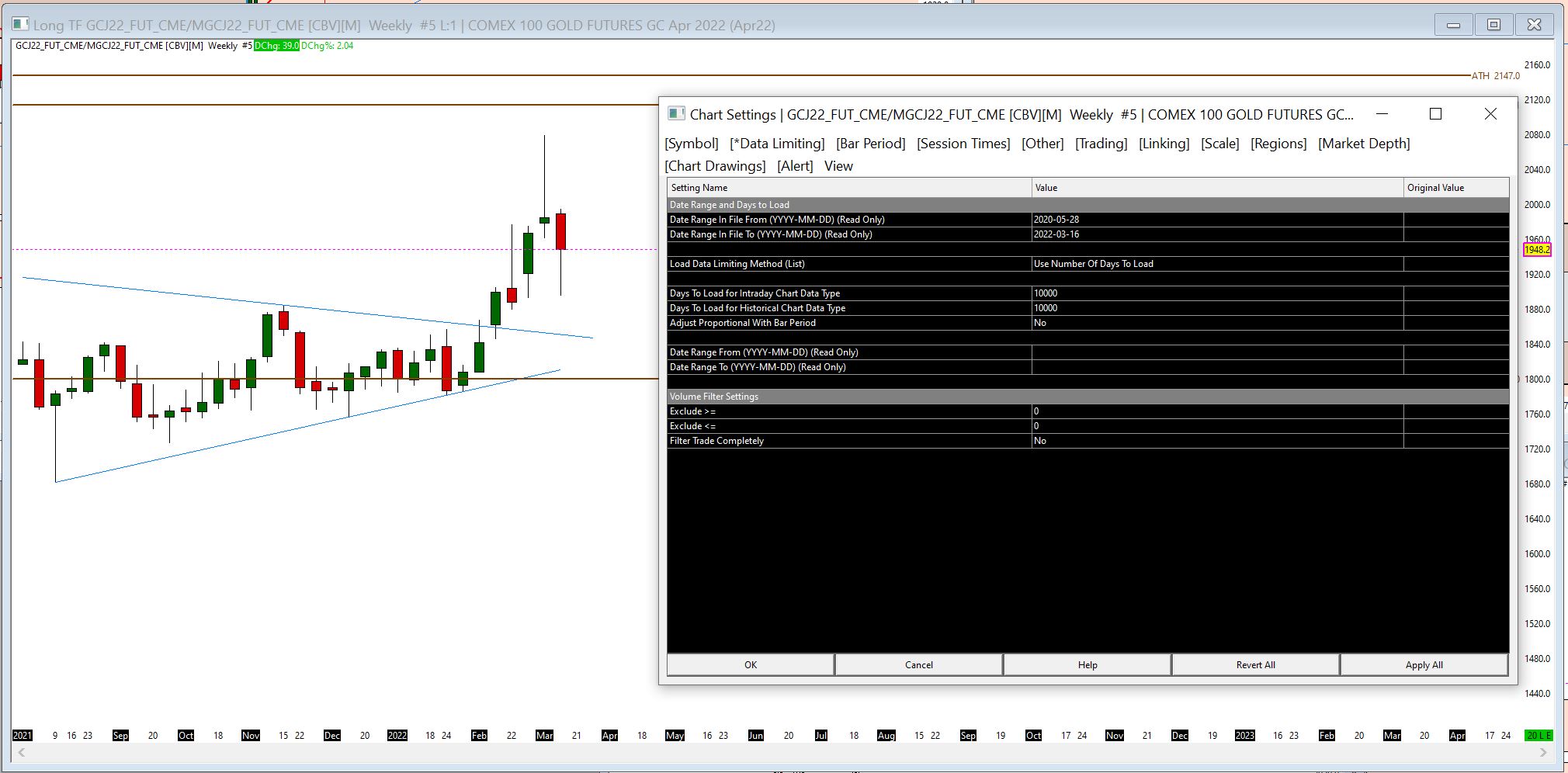

I have checked and this is all correct. Attached are a couple of screenshots of an example. You can see that there are still drawings on there from prior to my transfer marking up historical levels. Also you can see that there is no ability to scroll further back, although I configured for a large amount of history. I tried linking the screenshots as requested using the Edit >> Screen Images >> Upload Chart with Overlays function, but it did not show the scroll bar.

We are able to get all the data when we open the chart, so we are not sure what is happening.
Please select Edit >> Delete All Data and Download, and when you get the Multiple Symbol Selection Window, then take a look and note the oldest symbol in the list. You should have to scroll up the list to get the oldest one listed. Please let us know what that symbol is.
Also, please go to Chart >> Chart Settings >> Linking and tell us what items are set to be linked for this chart.

Hello. The oldest one is Z94. OK, so when, within that window, if I Select All, I then get the historical data. I didn't have to do that previously, I just set the value in the "Days To Load". Is this a change with the new version?
[2022-03-18 15:11:40]
If there has been some previous issue with downloading historical data you do need to select all of the symbols in the symbol selection window and re-download the data again.
