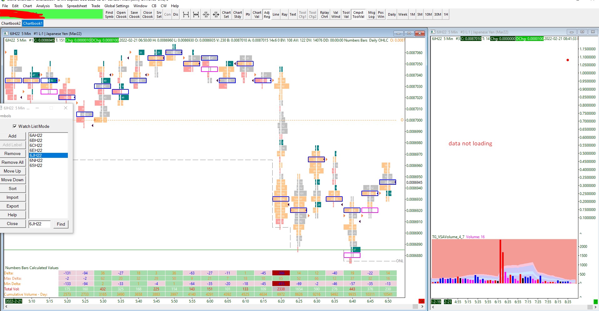

multiple chart change time data not loading
imageScreenshot_226.jpg / V - Attached On 2022-02-21 03:14:18 UTC - Size: 334.48 KB - 274 views

You have signed up for the Non-Professional CME exchanges, which means that you need to connect to your live, funded futures trading account at the beginning of each month to qualify for the lower-priced exchange fees. You have not connected to your trading account yet this month. Refer to the following:
[2022-02-23 18:36:31]
Regarding that one chart in the screenshot you provided, if you still have issues with it, then reset the scales with Chart >>Scale >> Reset Scales.
One thing though that we definitely see is that you are paying for the CME Group exchange fee through the Denali Data Feed but you are not able to access the Denali data feed data for the following reason:
The reason you are not getting real-time data from the CME Group of exchanges is that you activated the Non-Professional exchange fees, but you have not verified in the last month that you have a live, funded, futures trading account, which the CME needs in order to allow you data at the lower priced fees.
Refer to the following for instructions on how to connect once a month to your *live funded* trading account to qualify for the lower-priced exchange fees:
If you do not have a funded trading account or one with a supported trading service, then refer to this solution:
Easy Solution to CME Funded Trading Account Requirement
Consider the above solution to avoid this problem in the future.
Make sure you are connected to your live Gain capital account.
