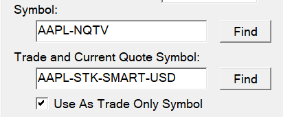

I use a linked quote board to my charts and trade directly from the chart DOM. The only way I've found to be able to use NQTV and send trades to IB is by using the attached example. This works fine for static charts but is there a programmatic way I can do this so when I switch between symbols the underlying trade symbol updates? Thanks
imageappl example.PNG / V - Attached On 2022-02-08 12:53:33 UTC - Size: 6.5 KB - 489 views

Once you understand that distinction between symbols please see the picture of the first post in the thread showing that while the chart symbol should end in -NQTV, the chart’s trade and quote symbol should end in -STK-SMART-USD.
