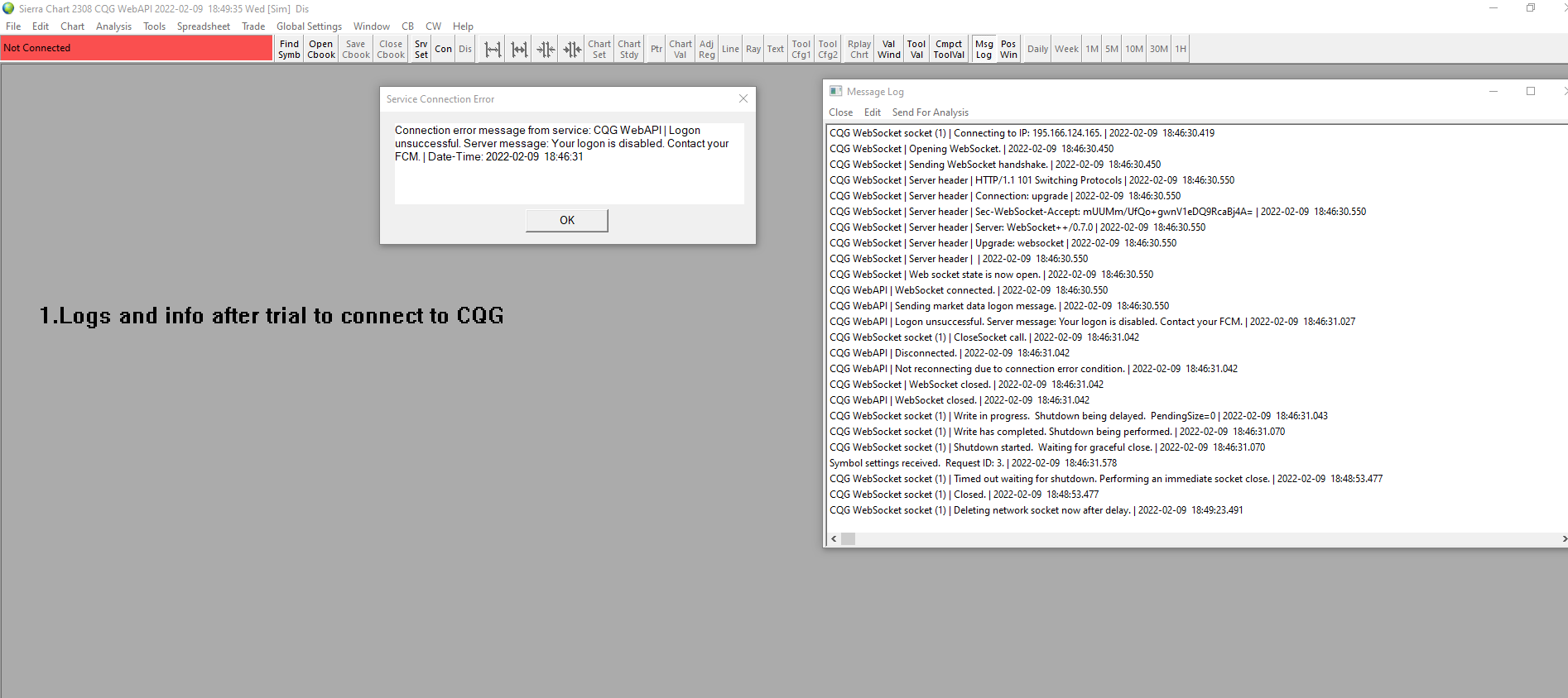

[2022-02-09 18:55:29]
User830657 - Posts: 10
Hi
All in two attachment files .
Best Regards
JT
imageerror 1.png / V - Attached On 2022-02-09 18:53:55 UTC - Size: 75.53 KB - 229 views
Private File
[2022-02-09 19:18:16]
John - SC Support - Posts: 48388
This is your issue:
CQG WebAPI | Logon unsuccessful. Server message: Your logon is disabled. Contact your FCM.
As it states, your CQG account has been disabled. You need to ask your broker as to why this is the case.

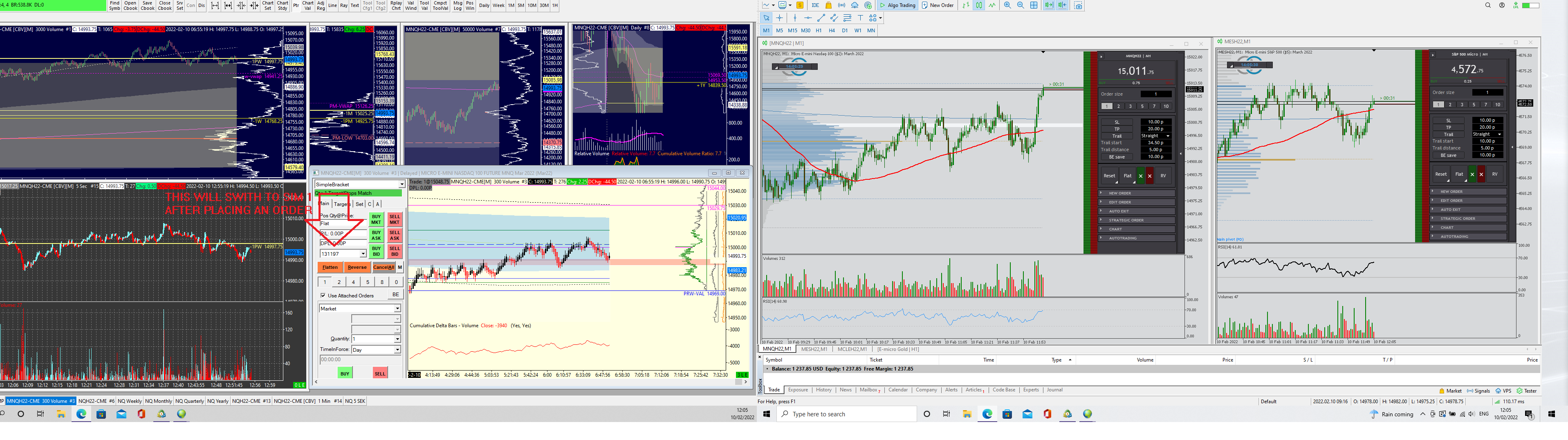

[2022-02-10 12:10:48]
Hi ok I would like to use your data and I done all to connect it , its not allowed me to trade in real account anyway even if my real is showed in trade window . placing order its switching from real 131197 to sim 1. Have a look on attachment file sierra data is delayed compare to mt5
imagesierra problem1.png / V - Attached On 2022-02-10 12:10:27 UTC - Size: 447.07 KB - 239 views
[2022-02-10 14:19:16]
You are still not using the Denali Exchange Data Feed. You need to complete agreements, and activate exchanges from here:
https://www.sierrachart.com/UserControlPanel.php?page=ServicesActivation#DenaliCME
Also update to the current version:
Software Download: Fast Update (This is important)
It looks like you want to be using CQG? If so, you need to follow through the instructions here:
CQG Trading Platform Service: Setup Instructions
Date Time Of Last Edit: 2022-02-10 14:19:40
