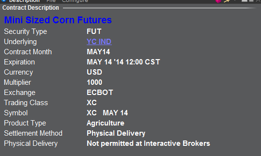

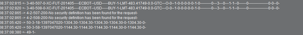

I requested the mini grain futures (XC, XW, XK) be added a while back to the CME real time feed for Interactive Brokers(IB). I recently tried to go live with them and it appears they aren't mapped correctly. If I submit a limit order it just sits there forever saying order sent and IB shows no order pending. I have attached a screen shot of the API log and a screenshot of the IB symbol info as well.

imageib mini corn futures api log.PNG / V - Attached On 2014-04-09 13:12:43 UTC - Size: 11.39 KB - 552 views
imagemini corn futures ib info.PNG / V - Attached On 2014-04-09 13:12:58 UTC - Size: 15.71 KB - 644 views

For XC we have added 1000 to the symbol to specify the multiplier. Restart Sierra Chart to get the updated symbol settings . Open a new chart for that symbol using the symbol that contains 1000 and give it a try. If there is still a problem, we do not know what else can be done. You will need to ask Interactive Brokers.

As for XC, it still doesn't work. Perhaps it needs to be mapped with YC as that is what IB considers the underlying even though CME uses XC.
