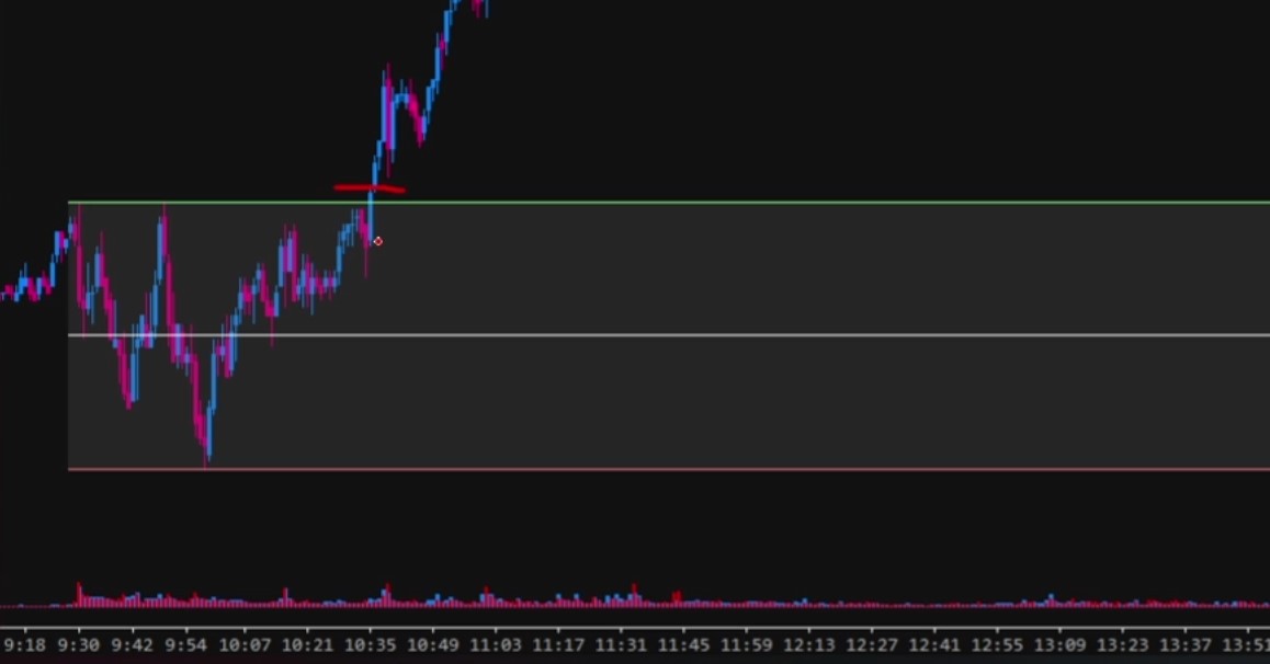

I'm trying to build the 30min openings range like in the attachment. I already found the study: High/ low for time period extended.
But i would like to ad a MID-POINT as well as a shadow (see attachment.
Thanks,
Dirck
image30 min openings Range.jpg / V - Attached On 2022-01-19 17:48:56 UTC - Size: 47.28 KB - 276 views

With regards to adding a Mid-Point, refer to the information on the Arithmetic Studies (in particular, the Study Subgraphs - Average):
Using the Basic Arithmetic Studies
With regards to the Shadow, refer to the following:
Chart Studies: Filling the Area Between Two Study Subgraphs within Same Study

I'm trying to build the 30min openings range...But i would like to add a MID-POINT
If you use the Initial Balance study instead, it has a midpoint subgraph.
Initial Balance
