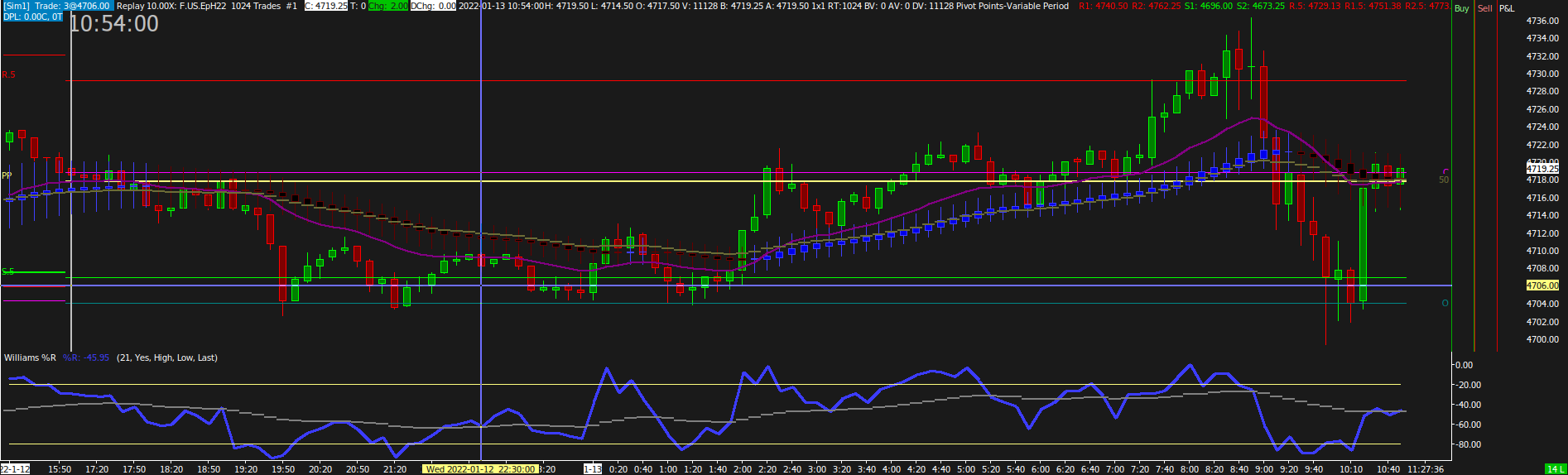

I have a weird problem. I inserted Clock - Real time study in the chart and it displays correct system time with seconds. When I do, replay chart, the chart refreshed and seconds are missing instead displays :00 .Screenshot attached.
Any help is highly appreciated.
https://www.sierrachart.com/image.php?Image=1642513858445.png
I also noticed at the bottom of the chart in the Time display grid seconds are missing ?

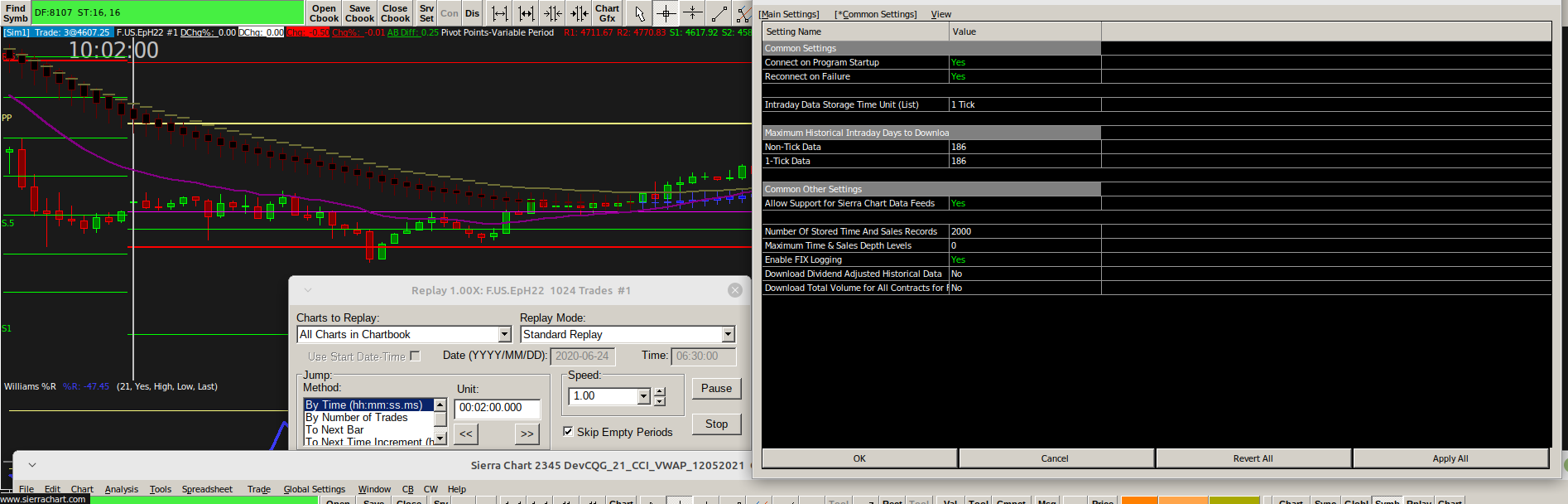

The problem is likely that you are just replaying one minute data. Not tick by tick or shorter time frame data. We see you are using CQG. For full tick by tick history, use the Denali Exchange Data Feed:
It will not help to get the chart in this case.
Set Sierra Chart to a Tick by Tick Data Configuration. Follow the instructions here to do this:
Date Time Of Last Edit: 2022-01-18 18:32:42

Hi John, I am attaching the chartbook in this response.
Sierra chart Engineering : I know what your are saying. However with CQG, I had seen seconds on the clock and in the bottom of the chart timescale before with this same settings. But now I am not. I am attaching the screenshot of the settings, which I am using right from the beginning.
https://www.sierrachart.com/image.php?Image=1642561226692.png
Thanks for the quick response. Let me know if you want anything else from me.
