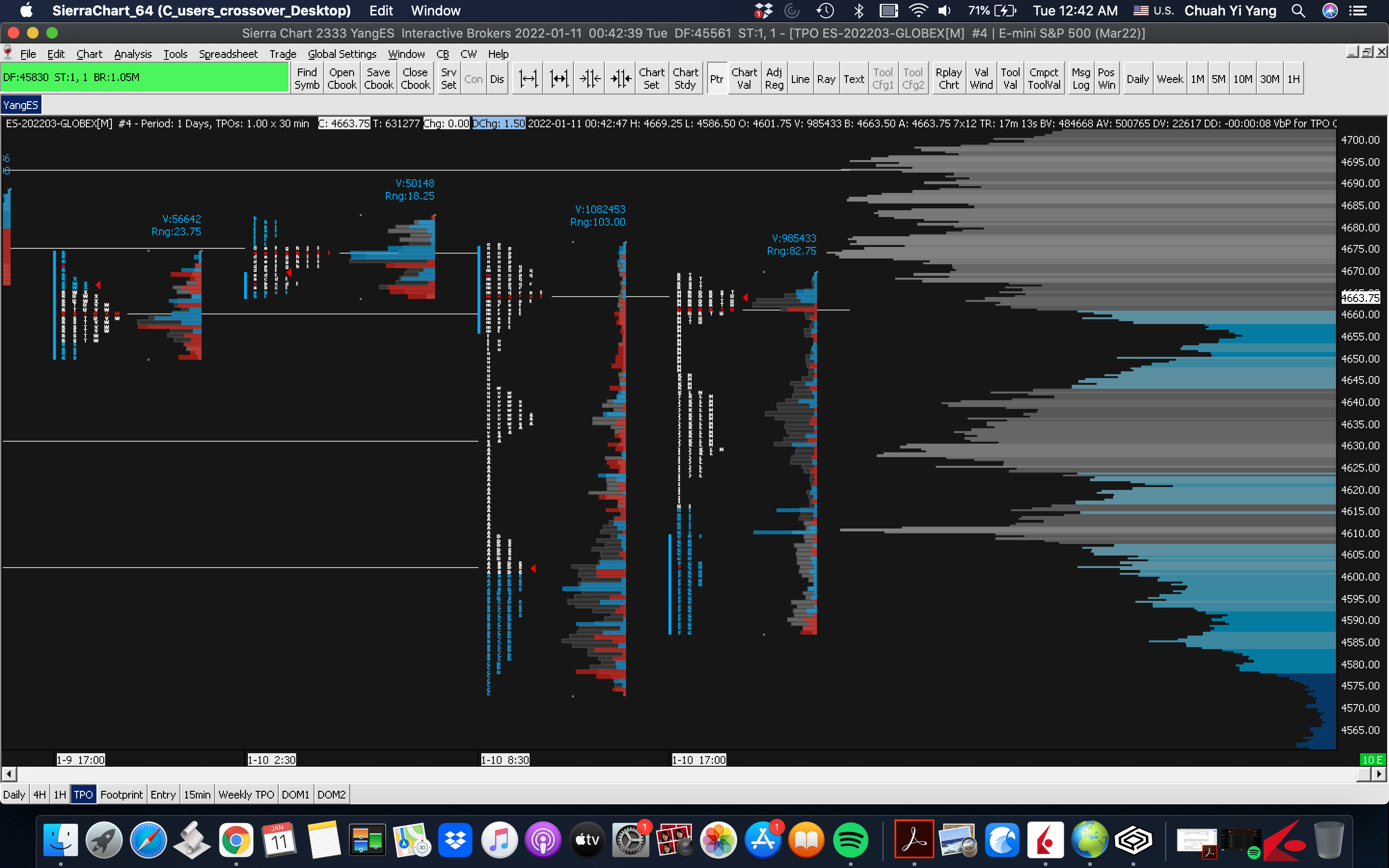

Hi, as attached in the image below, there's display of the numerical value of the volume and range above the TPO Bars. Where should I go to in settings/studies to add the numerical value of the volume, range, and also net delta for my other candlestick charts ?

User907968 - Posts: 885
You could use
'Numbers Bars Calculated Values' - https://www.sierrachart.com/index.php?page=doc/NumbersBars.php#s300
or
'Study Subgraph Above/Below Bar as Text' - Study Subgraph Above/Below Bar as Text
[2022-01-11 17:48:29]
You can not access that displayed data from a TPO chart. Therefore, you would have to find another way to get the information. As mentioned above, you could setup an intraday daily chart and then use the Numbers Bars Calculated Values to get some of the data you want (like Volume and Range).
[2022-01-11 18:42:15]
Yang_666 - Posts: 10
What if I don't need the Volume,Range, and Net Delta from a TPO but just a normal candlestick ?
[2022-01-11 18:55:37]
That is what we were referencing you to. It just depends on what you need and where to find it. As mentioned previously, the Numbers Bars Calculated Values give a large number of data points. Or, you can find another study to do what you want.
Then to display the data on another chart, you can use the Text Display For Study From Chart study. Refer to the following:
Or you can overlay the other study:
Study/Price Overlay Study
