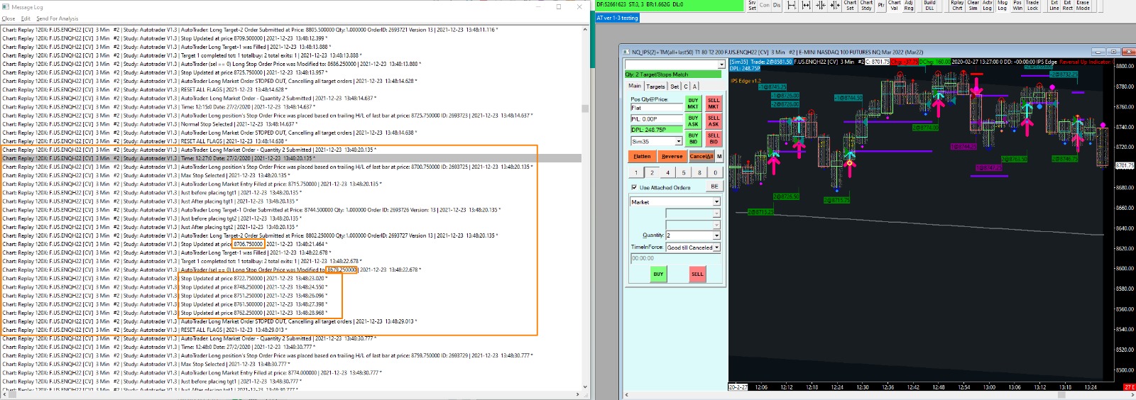

The results are correct till 120X but it is incorrect at 240. At 240X the study gets stuck and doesn't work properly. What could be the cause of it and how to fix it.

attachment120X Correct.jpeg - Attached On 2021-12-24 10:00:59 UTC - Size: 302.81 KB - 238 views
attachment240X incorrect.jpeg - Attached On 2021-12-24 10:01:03 UTC - Size: 182.63 KB - 313 views

From my experience, it's not always possible.
To some degree, replay speed will always affect results.
It takes time for an autotrader to move stops, so if the replay speed exceeds those intervals, things get skipped.
If you get accurate results at 120x, but not at 240x, then use 120x.
