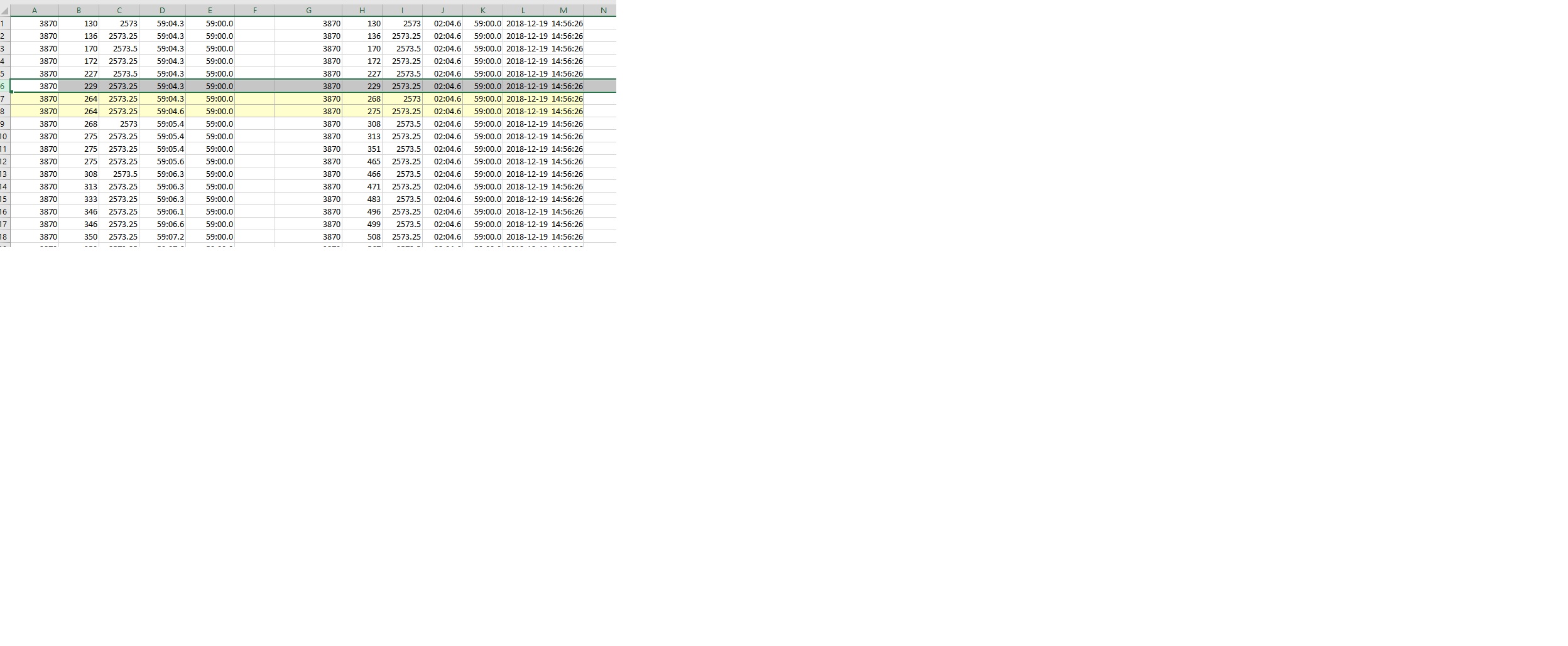

We have noticed that there is an issue with different speeds in Replay, the filled prices are not the same.
We suspect that it is related to that in different speeds 0.1X, 1X, 40X, 80X we see diffrent prices (using simple TEST study).
We see fewer prices when running in higher speed.
* See the attached screen shot of a test result that we did in speeds 1X and 80X, in the right side (80X) there are missing prices.

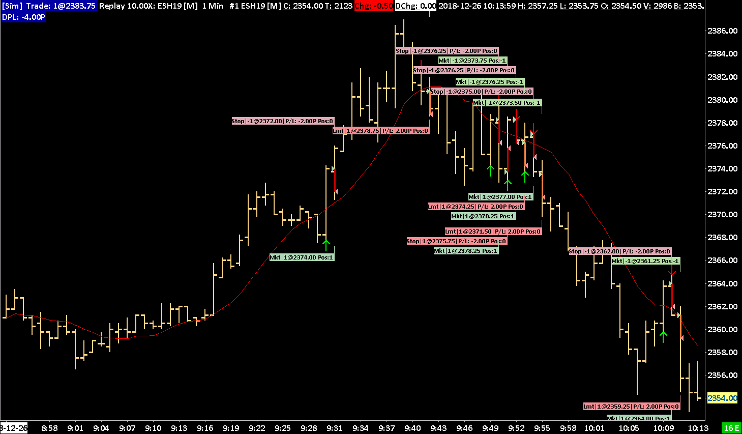

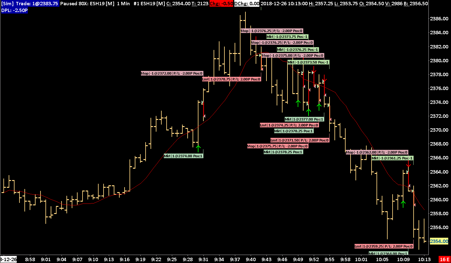

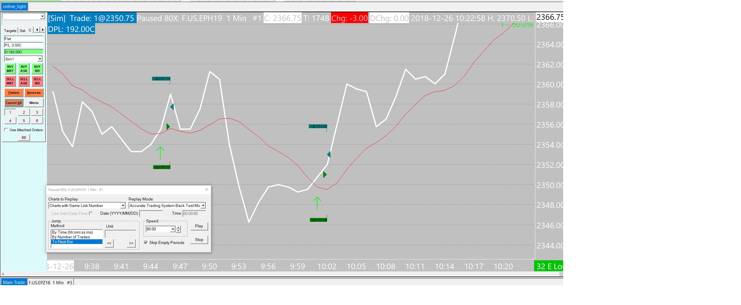

UserZiltoid - Posts: 57
Anyway,
I have taken you're code example: "scsf_TradingExampleWithAttachedOrdersDirectlyDefined" -
didn't change anything just compiled it and ran it as replay on todays chart. got 2 different results in 10X speed and 80X speed.
See attached screen shot.
in the 80X there is a missing SHORT position.
it is the same study, same time, different speeds.
Please tell me what am I doing wrong.
Thanks.

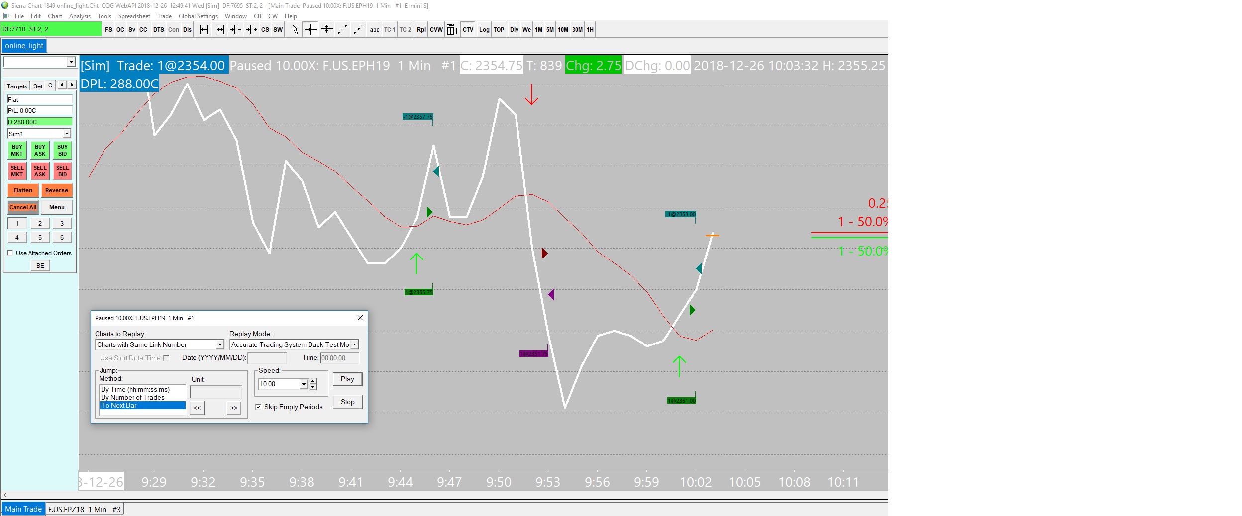

imagespeed 80X.jpg / V - Attached On 2018-12-26 18:58:06 UTC - Size: 332.07 KB - 572 views
imagespeed 10X.jpg / V - Attached On 2018-12-26 18:58:14 UTC - Size: 336.03 KB - 563 views

We did the very same test and we see identical results:
http://www.sierrachart.com/image.php?Image=1545853048475.png
http://www.sierrachart.com/image.php?Image=1545852909523.png
This is starting the replay at 09:30 US Eastern time on 12-26. And all prior trade data is cleared for the symbol and account.
So we do not know what you are doing differently. Set the Charts to Replay setting to Single Chart. We would not expect that to make any difference though.
[2018-12-26 19:44:48]
Actually we can tell now that the problem is indeed due to replaying multiple charts. It does look as though that that would change the processing. We need to look into that but currently the way that it works is by design.
