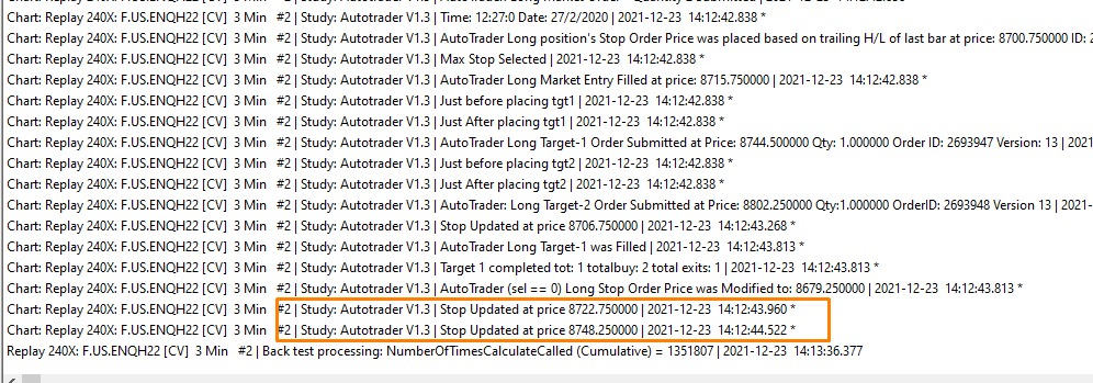

The results are correct till 120X but it is incorrect at 240. At 240X the study gets stuck and doesn't work properly. What could be the cause of it and how to fix it.
The code how we update the stop loss is provided below:

Here depending on the user setting we decide how to modify/trail the stop.
Is it possible that the due to the replay speed the prices are moving faster than the update of the stop loss causing the issue and differences.
How to do it so we get consistent results across all the relay speed
