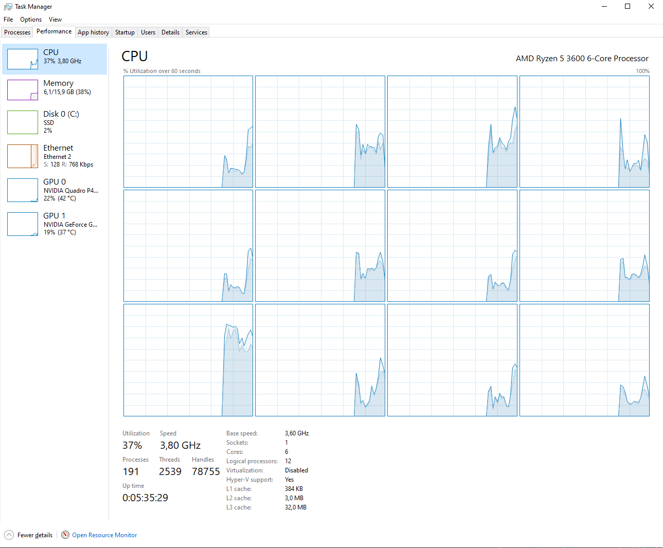

Lander - Posts: 4
Overall CPU usage is between 15-40% with only SC running. Antivirus is windows defender with the entire SC folder excluded.
As they state in the documentation, CPU usage should be below the 8% on my system. But that seems highly unlikely that sc only runs smooth if it's below that...
imagepreformance manager.PNG / V - Attached On 2021-12-08 14:41:40 UTC - Size: 96.03 KB - 358 views
