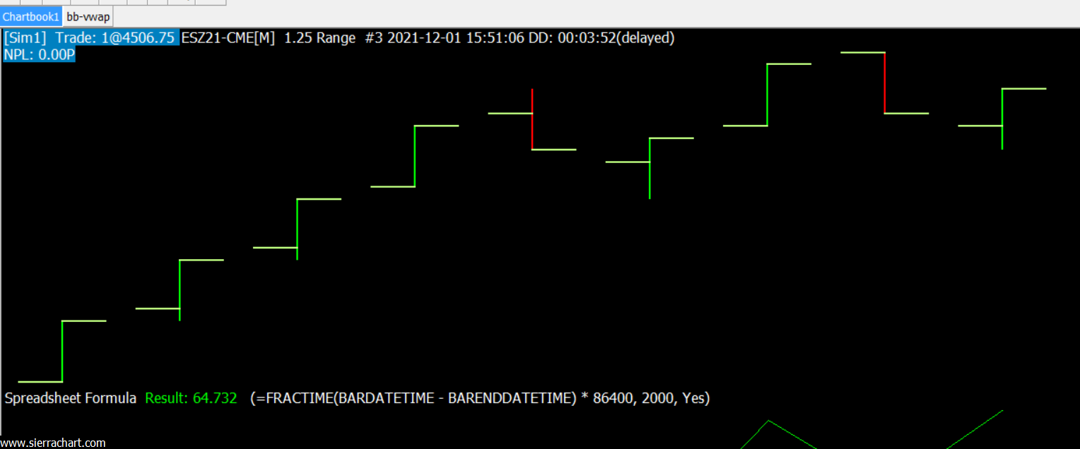

It looks like the time is just too small to use the method we gave you. Rather, enter the following formula in your Spreadsheet Formula study to get the bar duration in seconds(and you can get rid of the Numbers Bars Calculated Values, unless you want to the see the information in there as well):
=FRACTIME(BARDATETIME - BARENDDATETIME) * 86400
[2021-12-01 18:33:17]
User277997 - Posts: 22
cut and past that formula and still get an NaN value with no line. Any other ideas ?
[2021-12-01 19:21:31]
We just tried it and it worked fine. You are entering it on the Formula Input for the Spreadsheet Formula, correct?

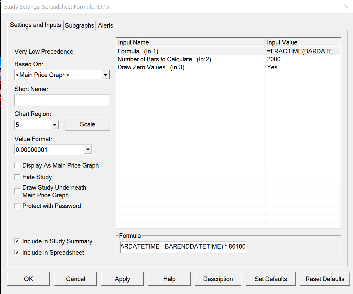

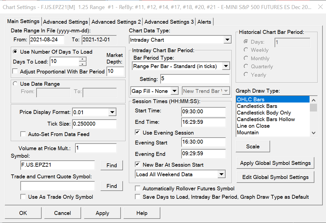

Correct. Here's the study settings window and the chart settings window.
imageScreenshot 2021-12-01 152917.png / V - Attached On 2021-12-01 20:32:23 UTC - Size: 68.51 KB - 272 views
imageScreenshot 2021-12-01 152946.png / V - Attached On 2021-12-01 20:32:31 UTC - Size: 108.04 KB - 305 views
[2021-12-01 22:05:38]
Here is what we see when we do the setup that you have:
https://www.sierrachart.com/image.php?Image=1638396280451.png

[2021-12-01 23:11:49]
There is something weird about your Region 3. Once we removed the Spreadsheet Study and the Numbers Bars Calculated Values that is in Region 3 (the one with just the Bar Duration on), then put the Spreadsheet Study back on, everything was working properly.
Without the above, we could not get even a simple calculation to show in the Spreadsheet Formula (we just tried "=H", which is the high of the bar and it did not work).
[2021-12-01 23:41:37]
yep - not sure where that weirdness came from but that did the trick. deleted the bar duration only calc values and the spreadsheet formula...added spreadsheet back and voila...just like I was hoping for. Again - thanks for the persistence on this one.
