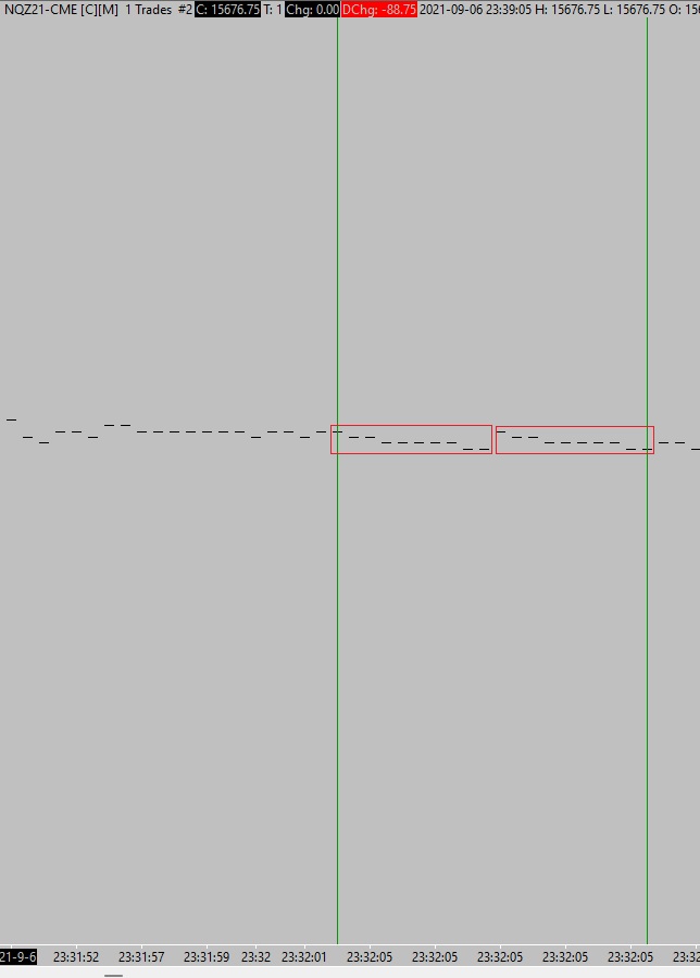

I wrote an ACSIL study which references a tick chart of the type “Number of trades per bar == 1“. Almost 99.9% of the time the study works correctly, but suddenly it does output nonsens data.
I started investigating and found data sequence errors in the chart. What I mean is, there should not be a tick with an older timestamp than the previous one. The time stamps should only be ascending and not suddenly descend for few ticks.
Further more I figured out, this behavior happens as soon I connect to the data feed and it is performing the backfill. The data sequence error happens more or less at the boundary of the already existing data and the new one.
According to the attached DSE* pictures, there are duplicated sequence of ticks.

As a consequence you have a few duplicate ticks in the chart. You can check this also in the Intraday data editor.
1 2 3 4 5 6 7 8 9 6 7 8 9 10 11 12 13 14 15
The amount of duplicated ticks is not fix. In the attached examples its something between three ticks and ten ticks.

imageDSE_1.jpg / V - Attached On 2021-11-30 10:19:15 UTC - Size: 49.92 KB - 325 views
imageDSE_2.jpg / V - Attached On 2021-11-30 10:20:00 UTC - Size: 50.56 KB - 284 views
imageDSE_3.jpg / V - Attached On 2021-11-30 10:20:10 UTC - Size: 41.86 KB - 317 views

I did more tests and figured out I reported the duplicate ticks at the wrong side of the data. They do not happen between existing data on the chart and the beginning of the backfill, but at the end of the backfill and the new incoming ticks after the backfill.
It also doesn’t matter if you connect to the data feed or if the data feed is already connected and I click “Delete and Download data”.
I can repeat “Delete and Download data” several times starting somewhere before the duplicate ticks. The former duplicate ticks are then gone / corrected but there could be new duplicate ticks at the end or not.
It feels like the backfill data comes from one source and as soon the backfill is terminated the data comes from an other source and there is a data overlapping between backfill and new ticks.

My "Tick data sequence tester" study reported one block of 29 duplicate ticks almost at the end of the new data.
I did visually check the chart according to the reported duplicate block. 29 ticks are repeated like the examples I already provided. The amount of duplicate ticks is totally variable. This time it was 29."
