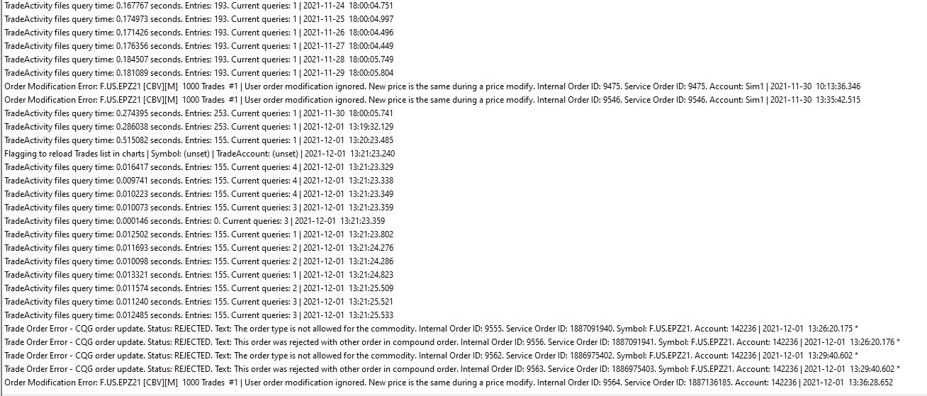

Hello, the problem above persists but now it initiates the OCO order (opens a position) but does not place the target and stop loss (or cancels them?). I am not doing anything different from what I used to do before in terms of placing or changing orders. Today it cancelled the target and stop loss when the position was opened. That put me in a terrible spot. I have attached the service log below. Thank you

At the bottom of the image of the Trade Service Log you provided it gives the information that the orders were rejected since the order type is not allowed ("The Order Type is not allowed for the commodity"). You would need to ask your broker why those attached orders are being rejected.
The one thing we can suggest is to look at the Time in Force for the Attached Orders and ensure it is not set to something that can not be used. But again, your broker will need to tell you what the exact problem is.

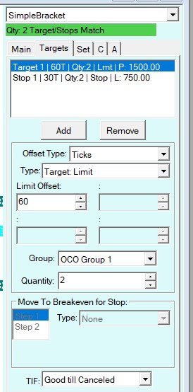

I checked the order types, they are simple stop loss and limit target orders, TIF is good 'til cancelled.

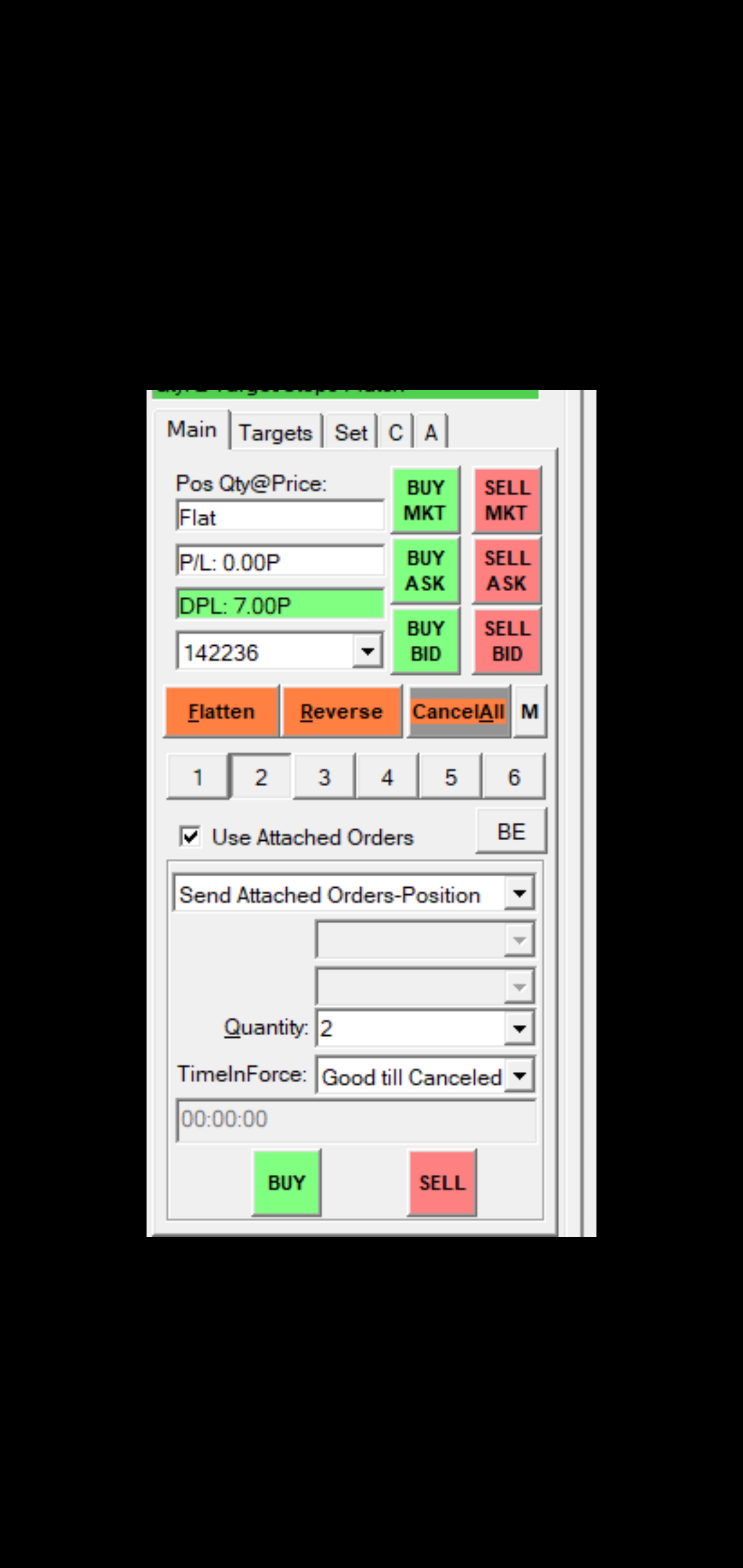

imageScreenshot 2022-03-01 100902.jpg / V - Attached On 2022-03-01 15:11:45 UTC - Size: 46.09 KB - 543 views

These order types are fine:
https://www.sierrachart.com/Download.php?Folder=SupportBoard&download=61926
One thing about Teton though is because the bracket order is server-side, If you are using an unsupported order type, the rejection would occur right at the very beginning and then you can resubmit. Not at a later point in time perhaps when you are not even monitoring the orders.
