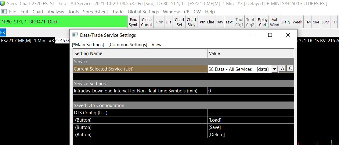

[2021-10-28 22:46:47]
User303119 - Posts: 7
Hi thanks for all of that.
I had downloaded the Sierrachart software and already was using the "SC Data - All Services" for delayed.
I have been through the setup process twice and will do again as I must have missed something.
I have a funded account, which is:
Stage 5 Trading Corp via Advantage FTP.
I have signed all of the agreements, even the Eurex though I didn't think I needed to.
The Service Settings referred to is the Data/Trade Service settings in the FILE drop down on the Sierra Chart software.
Ive attached some screen shots.
Thanks Bg
imageSierra.JPG / V - Attached On 2021-10-28 22:14:51 UTC - Size: 87.84 KB - 343 views
imageSierra Screen Shot Acc.JPG / V - Attached On 2021-10-28 22:15:00 UTC - Size: 88.63 KB - 347 views

[2021-10-29 00:45:13]
You have not been through all of the Setup Instructions. We know this as the main item you are missing is activating the exchanges. Please go through all of the Setup Instructions at the following link to ensure that you have everything completed:

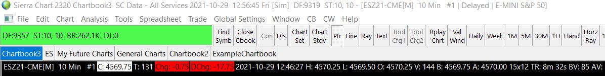

[2021-10-29 02:00:25]
Hi Again
I have gone over the additional area I overlooked and think I have done everything, but get to the end point 9. Sierra Chart Software Instructions (Denali Exchange Data Feed Setup Instructions) and I still have delayed data. See screen shot.
Sorry for all the hassle !
Thank you
imageSierra3.JPG / V - Attached On 2021-10-29 01:59:18 UTC - Size: 55.35 KB - 318 views
[2021-10-29 14:07:09]
You have signed up for the Non-Professional CME exchanges, which means that you need to connect to your live, funded futures trading account at the beginning of each month to qualify for the lower-priced exchange fees. You have not connected to your trading account yet this month. Refer to the following:
