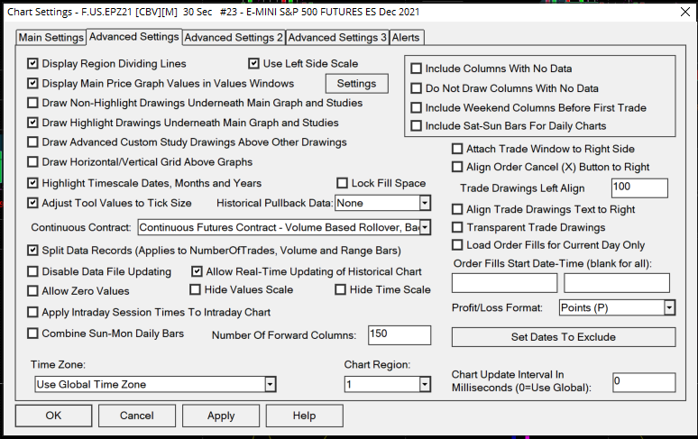

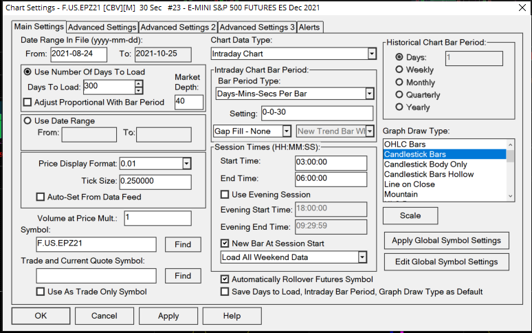

- 'days to load' > here you can see the setting 300 days backward
- 'continous contract' > here you can see my setting for using the continous contract.

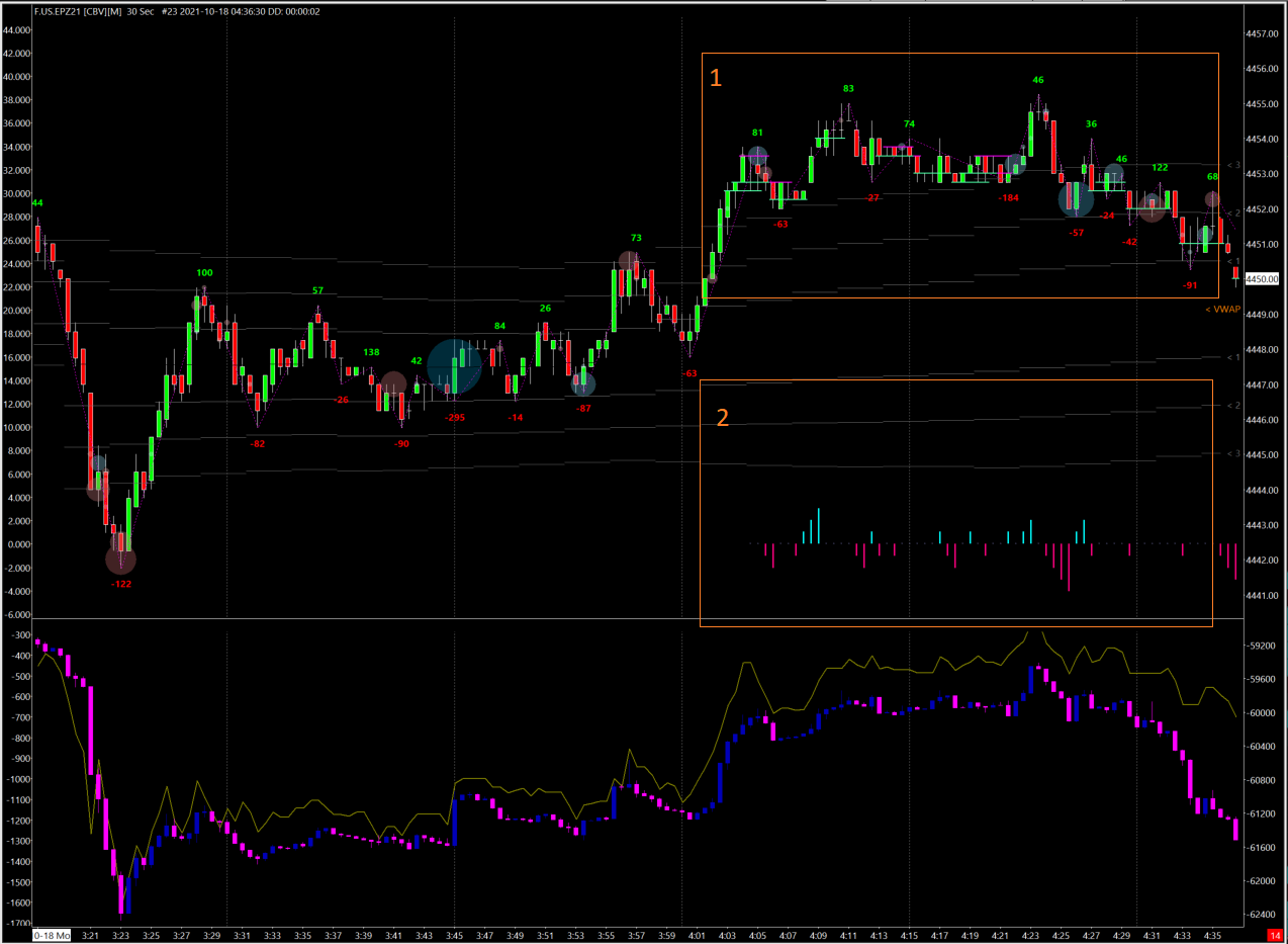

- 'chart with no stadies before 7 days' > here is the situation on October 18th. starting at 4AM the studies are displayed. before they are not. The rectangle 1 and 2 show some 'color bar based on alert condition studies'. Nr.2 is a bit complicated. So lets Focus on Nr 1. Nr 1 shows horizontal lines just
going arround 4 candles backward and display a line showing that no candle has closed above / below a certain level. And as we can see, After 4Am 7 days backward the study is displaied and still going on. Before it is not.
Thanks very much !!

Keep in mind the Color Bar Based on Alert Condition study has an Input for the Number of Bars to Calculate. By default this is set to 2000. So if you are at 2000 bars from the end of the chart at that location, then that is the reason.
Also, other studies have limits as well on the number of bars/days/etc. for which they are calculated. Make sure the studies that the Color Bar Based on Alert Condition is referencing have the data going back far enough for them as well.
