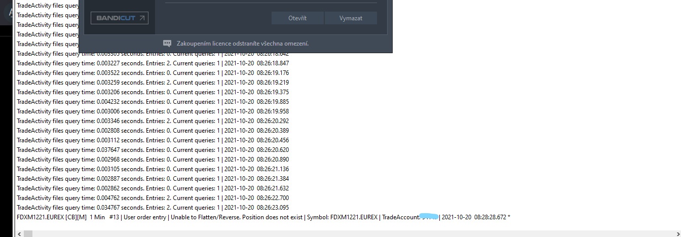

User667154 - Posts: 10
I too... /sierra 2320/
Date Time Of Last Edit: 2021-10-20 08:02:58
imagebandicam 2021-10-20 08-22-52-253.jpg / V - Attached On 2021-10-20 07:52:18 UTC - Size: 211.27 KB - 329 views
imageInkedbandicam 2021-10-20 08-27-58-707_LI.jpg / V - Attached On 2021-10-20 07:52:25 UTC - Size: 1.25 MB - 386 views
imageInkedbandicam 2021-10-20 08-29-33-653_LI.jpg / V - Attached On 2021-10-20 07:53:04 UTC - Size: 1.08 MB - 360 views

I just realized what has happened. During the day an buy order was placed, but the platform did not see the order was filled, and then tried to cancel this order, and finaly did not see the position. But on the broker side, the order has been filled. What I see at the end of the day is just the correction of the position. I have attached both logs.
My question is how to detect or prevent this behaviour ?
Date Time Of Last Edit: 2021-10-20 20:59:18
imagelog from sierra.PNG / V - Attached On 2021-10-20 16:35:28 UTC - Size: 54.02 KB - 241 views
imagelog from rithmic.PNG / V - Attached On 2021-10-20 16:35:35 UTC - Size: 8.15 KB - 257 views
