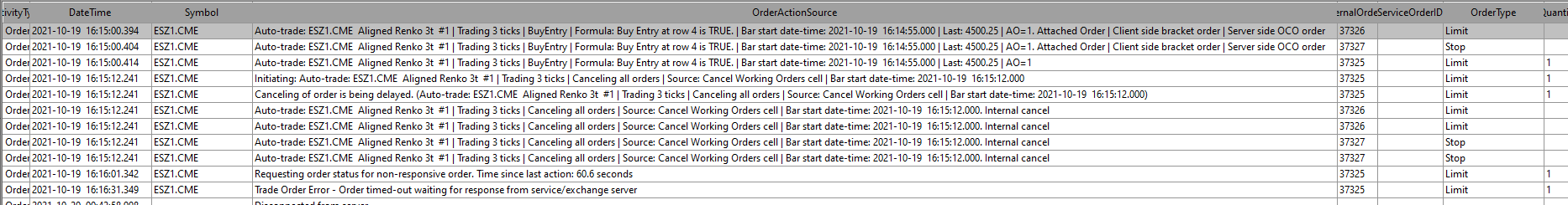

thank you for the answer.
I just realized what has happened. During the day an buy order was placed, but the platform did not see the order was filled, and then tried to cancel this order, and finaly did not see the position. But on the broker side, the order has been filled. What I see at the end of the day is just the correction of the position. I have attached both logs.
My question is how to detect or prevent this behaviour ?

imagelog from sierra.PNG / V - Attached On 2021-10-20 16:35:28 UTC - Size: 54.02 KB - 241 views
imagelog from rithmic.PNG / V - Attached On 2021-10-20 16:35:35 UTC - Size: 8.15 KB - 257 views
