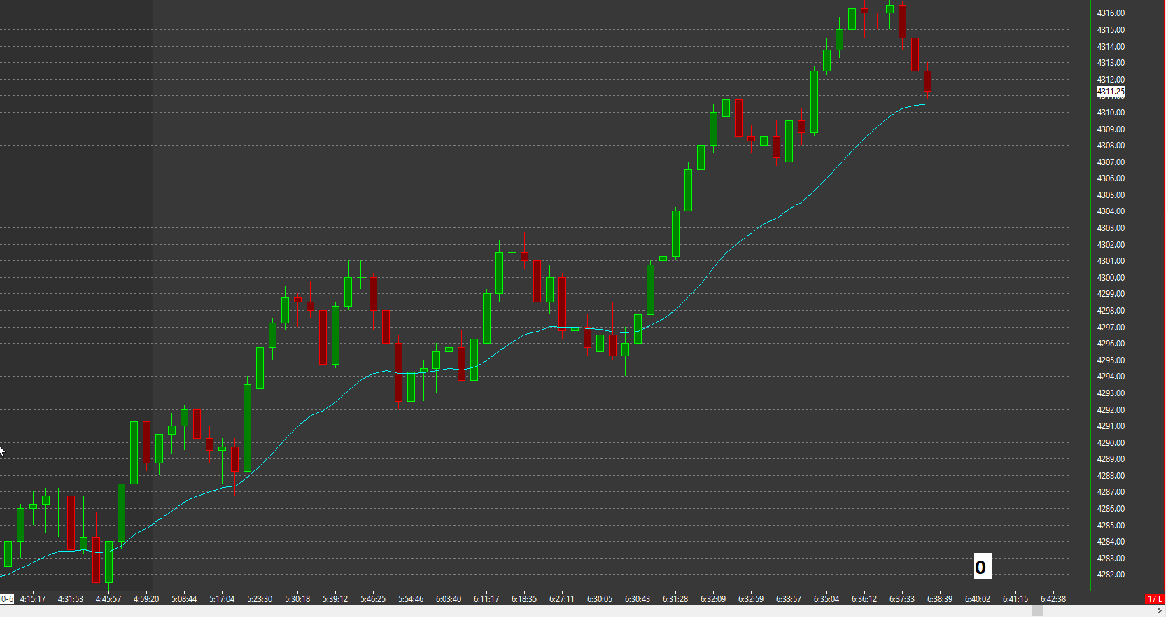

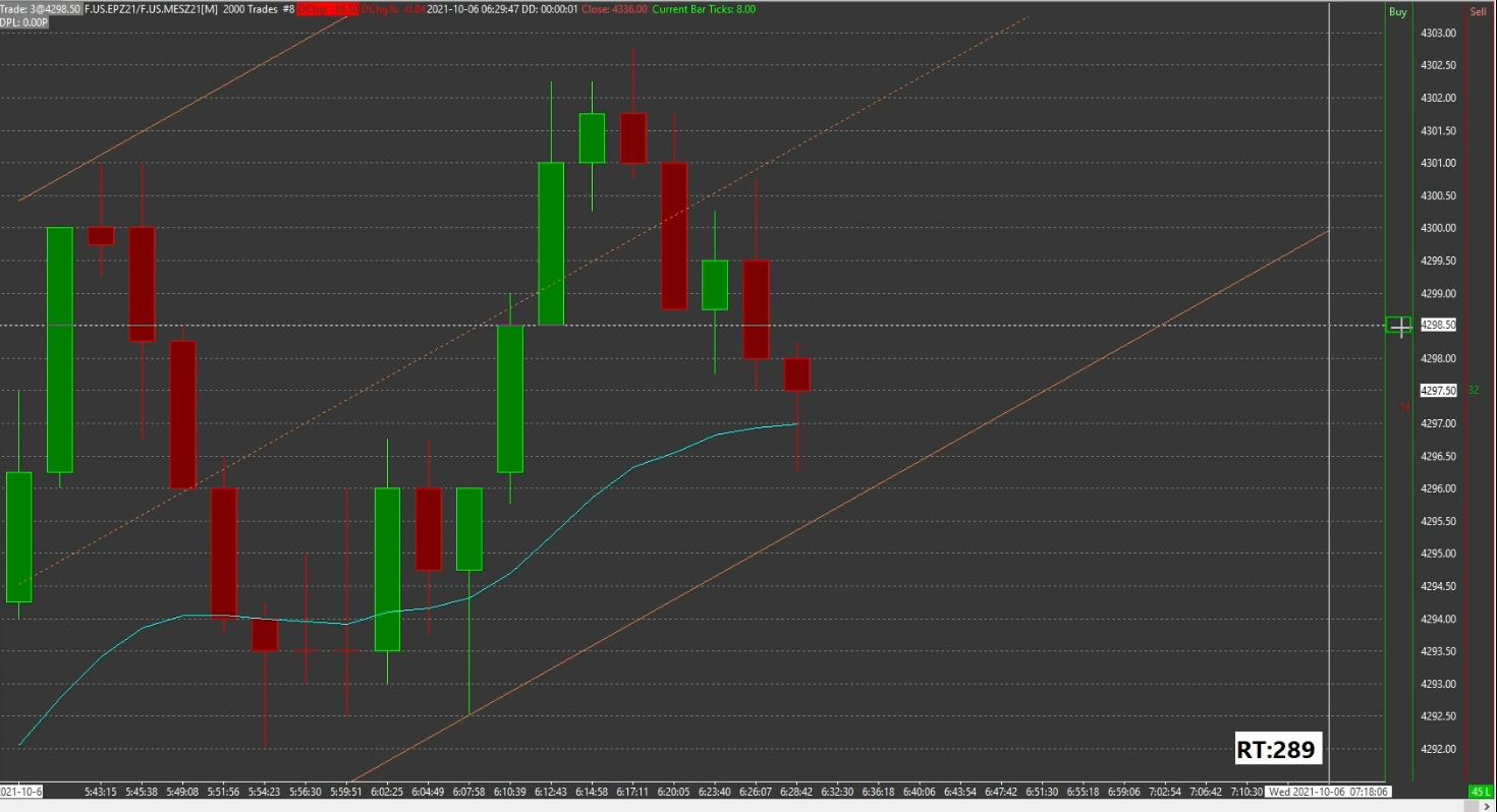

I have attached the two charts. Most notably the difference is at 6:18 on the photo
imageLive Data.png / V - Attached On 2021-10-08 00:56:32 UTC - Size: 347.06 KB - 382 views
imagereloaded data.png / V - Attached On 2021-10-08 00:56:43 UTC - Size: 54.58 KB - 365 views

The images are of the same chart, just with a Reload and Recalculate done between them?

The two charts have a "delete all and download" between them. The first one was from a screen recording live during the trading day. The second image and the attached book are after download. I was comparing charts with a couple of people using a different platform/data and my chart was different live from theirs. However, after delete and download they are identical.
I understand the issues with comparing charts like this, however all the charts compared have the same "start new bar at time" setting with the same time being used.
